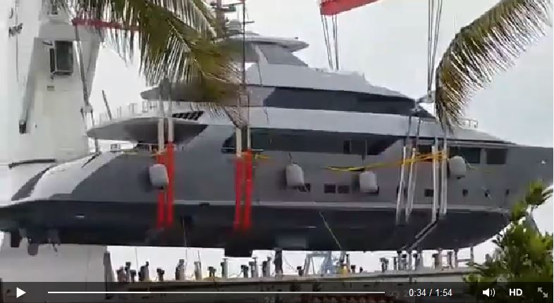

    You'd think someone would check things like... oh, I don't know... load ratings of the straps?

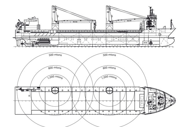

    That is a very typical accident on a heavy outsized cargo vessel with off center lifting gear. Due to the lifting capacity of the cranes at a specific outreach, the cargo sometimes has to be offloaded to the side, where the lifting gear is located. If the cargo then is longer than the distance between the two cranes, things are getting much more dificult. The lifting, turning and balancing of this heavy and large cargo with two independent and manually operated cranes, operated by two seaman and controlled by radio from the cargo master standing on deck, needs some professionalism. Very easily, the cargo straps start sliding, are getting damaged by sharp edges on the cargo (i.e. fiddles or stabilizers) which lowers their capacity and their goes the load. This constant movement of two independent hooks in azimuth, outreach and cable length, takes some very proficient crane operators and a very good cargo master. But this extremly slow cargo handling looks like less than ideal skilled operators and lack of communication. Old and worn out or pre dammaged cargo straps may have contributed to this accident also.
    Hopefully nobody got injured or killed.
    Below an example of one of those vessels and its lifting capacity versus outreach.

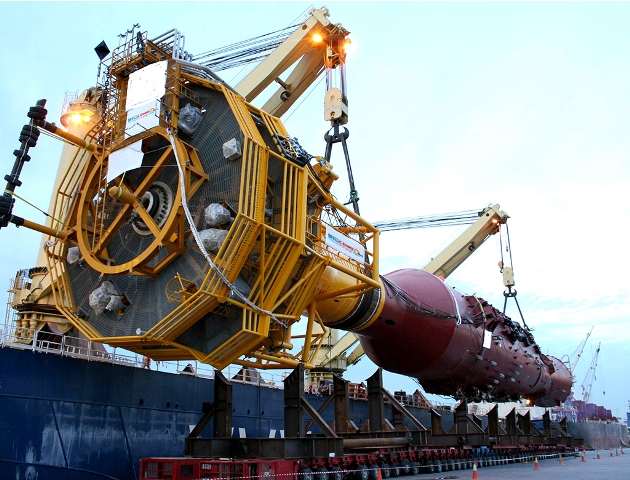

    NYCAP +1 from me. Sometimes, when I watch my crews and the heavy cargo handling specialists, lifting a 30 Million Euro piece of almost 300 ft long, 1000 metric ton heavy cargo (like a new cracking tower for an oil refinery or similar) from an inland waterway cargo ship or a barge onto the ocean vessel, I cannot stand the tension and leave the scene. Those specialists really earn every cent of their salary and their bonuses.
    A little boat is peanuts in regard to one of those giant loads. But sling loading a large yacht is not a very comfortable task either. A faired, high gloss hull and some very delicate appendages can easily be damaged. But the thing, I hate the most is, if people are standing on that yacht, while in the air. Thanks god, that this is forbidden and not tolerated in my country.
