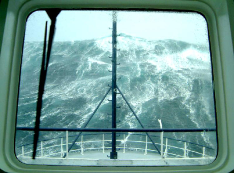

    For all you rogue wave "enthusiasts" :
  19. karldiesen
    karldiesen New Member
    Oct 18, 2005
    6
  20. karldiesen
    Oct 18, 2005
    6
    Hope someone enjoys ;)
