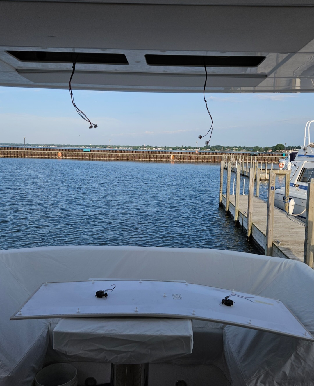

    I have a 2021 Sunseeker Manhatten 52 and woke up in the marina this morning to find an overhead panel had fallen off in the cockpit. It has ball and socket fasteners. I put it back up with a little E 6000 adhesive on the ball and socket fasteners.

    How would you remove a panel that is ball and socket on the ceiling with other panels tight to the next panel??

  10. Capt J
    14,643
    Easy, get a flat putty knife under the side. Or easier, remove a light and stick your fingers in there and pull.
  11. d_meister
    d_meister Senior Member
    Mar 4, 2010
    487
    La Conner, WA.
    Be very careful with any tool you use. The smallest burr or sharp edge can damage the material very easily. The suggestion by Capt J to pull a light and then pull down on the panel is a good one, and should be the first method attempted.
