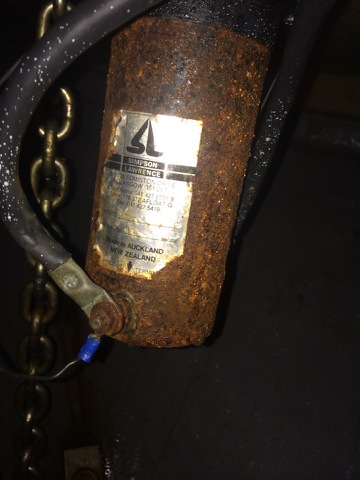

    Hi people.
    Maybe this is a shot in the dark, but i will try anyway. :)
    I recently bought a 1993 Sunseeker 62 Manhattan with 2 x Detroit 8V92's in it.
    My question is:
    Does anyone know where the units to control the ancor winch in this boat can be? The unit that controls the +- signal to the winch. I have searched everywhere i can think of without luck, especially in the engine rooms. I cant find it in the main engine room either.
    Any ideas?

    Thanks a lot for reply. I have found a automtic breaker for the winch in a small electrical/aircondition room in the middle of the boat. There is power to that breaker and the breaker is working. So the power goes forward, some place, to the -/+ solenoid that changes direction on the winch i think, but there is still no power to the winch at all. The switches inside the boat are working. So i assume the swithes will give power to a solenoid some place. The big question is where.. :)

    Are you sure it is not hydraulic..?

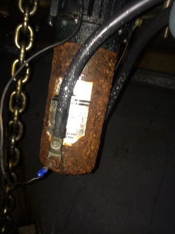

    AMG: Yep :)
    Se attached pictures.
    Rodger: The anchor and thruster have seperate power buttons, but maybe it will be a good idea to check if the winch/relay get its power from the thruster main cables..
