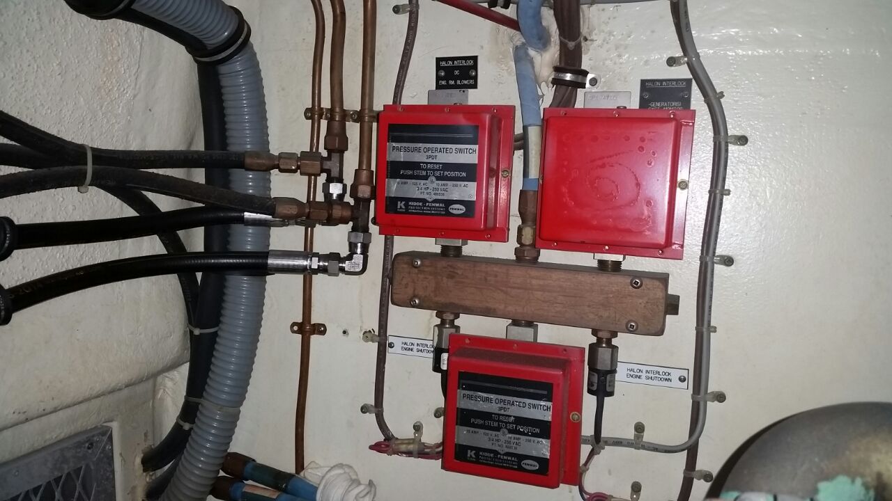

  7. Capt J
    14,650
    Because the relay box or brain for the fire system is bad. Shutting off the ignitions and turning them back on resets it. It's most likely is the lower box mounted engine shut downs in the picture, there is most likely a relay in there that's bad. That is why the generator isn't shutting down, it has a seperate shutdown box (top/right). Hire someone who is competent in fixing the problem.

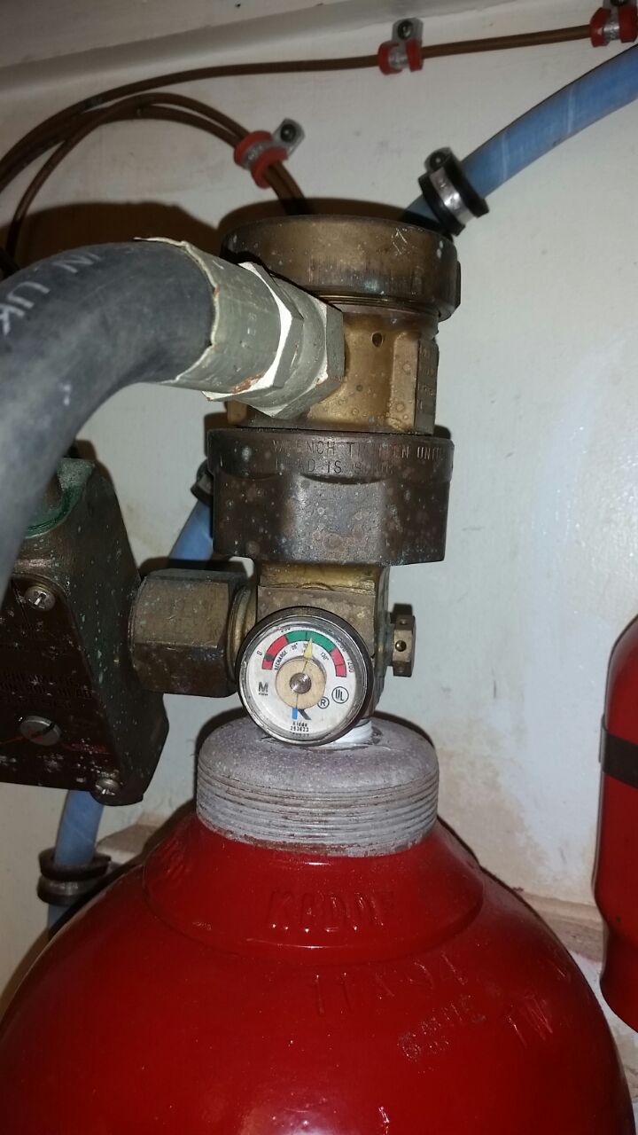

    But if that was the case (relay box or brain for the fire system is bad), how come that the pressure on my fire bottle is ok? I guess that if the relay stut off the engines, also will shut the Halon system. IMG_0683.JPG

  11. Capt J
    14,650
    Because the relay is BAD. It has nothing to do with your fire bottle discharges, it reacts after the bottle starts discharging and shuts the engines down, just as if you switched the keys off.

    But if the relay reacts after the bottle stars discharching and shuts the engines down, why the bottle didn't discharged? That's why I posted the picture of the gage that show the bottle's pressure full. If the relay reacts that means it will start to discharge the bottle and also shuts the engines down, just as you mentioned. Here in my boat, never started to discharge the bottle when both engines shut down.... that's the rare thing.
  13. Capt J
    14,650
    No, it's more common for a cheap electrical relay to just wear out and falsely close than for a justifiable reason (fire bottle discharge). The Relay or pressure operated switch is old and BAD/DEFECTIVE, so it is shutting the engines off for no reason at all....not because it is doing the job it's supposed to do. You need a NEW RELAY or pressure operated switch. Open that and the generator box, if they use the same brand/type of relay swap them and see if the shutdown issue moves over to the generator. I'd just replace it and keep a spare, the relays are probably cheap.
    In your era of DDEC it was very common for the relay to do nothing more than send a shutdown feed/code to the DDEC computer, just as if you turned the key switch off.

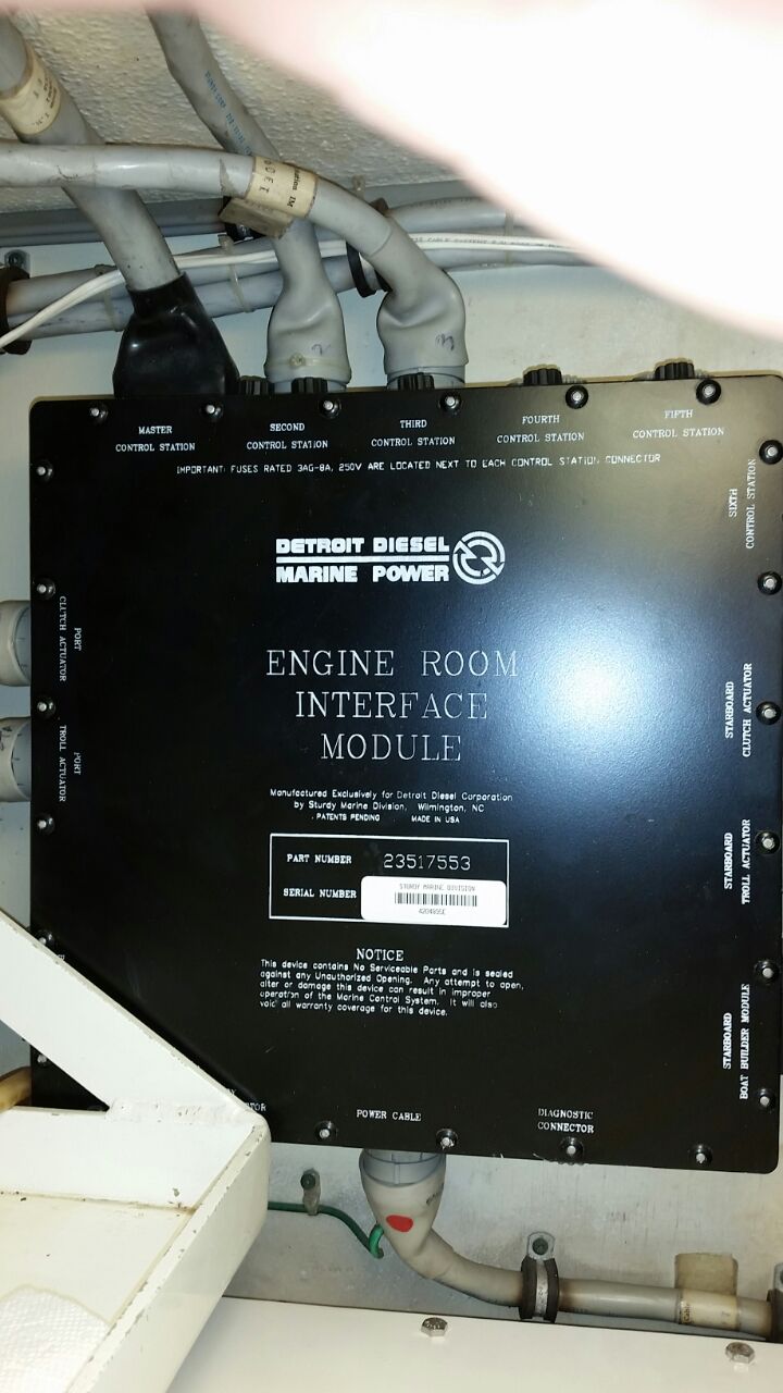

    Also the Engine Room Interface Module is a common supply for both engines..
  17. Capt J
    14,650
    Yes, those are the engine controls. I think, if that fails both engines go to neutral and not shut down. You would need to call Sturdy to find out, they were the manufacturers. Check the battery bank those are powered by.
