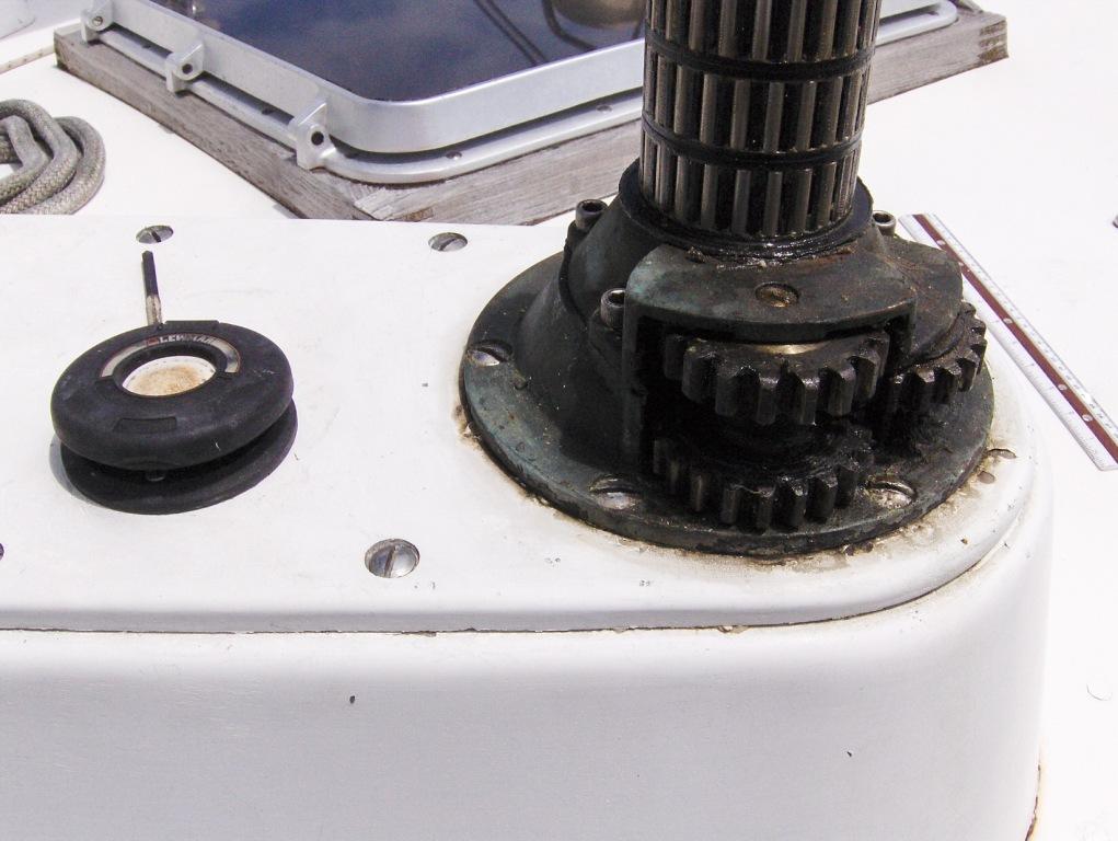

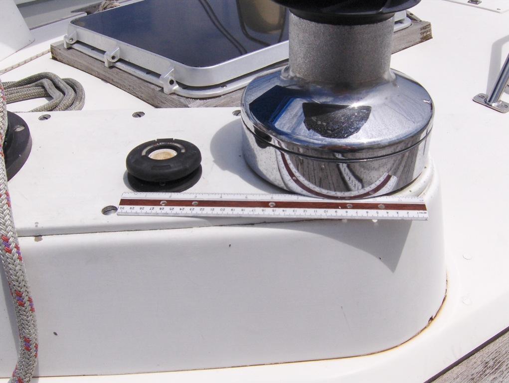

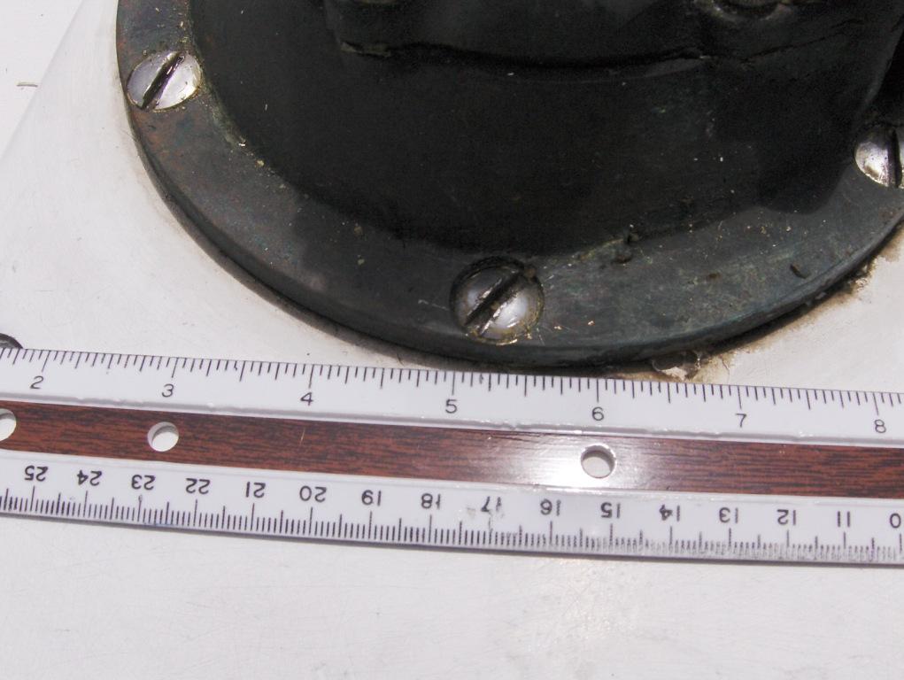

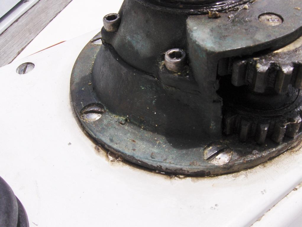

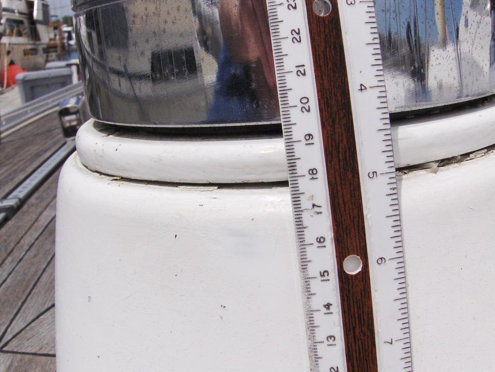

    Thanks, again, for all the advice. Here are the pictures:
    pedastal1 is with the drum.
    pedastal2 is without the drum showing bolt screws.
    bolts1 through bolts3 show the screws holding the winch in place; those bolts are the ones I'm trying to remove.
    A couple more pictures in the next post.

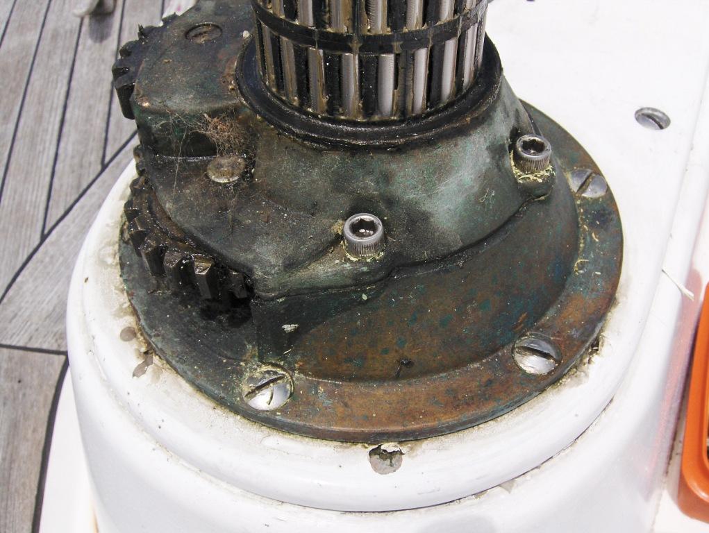

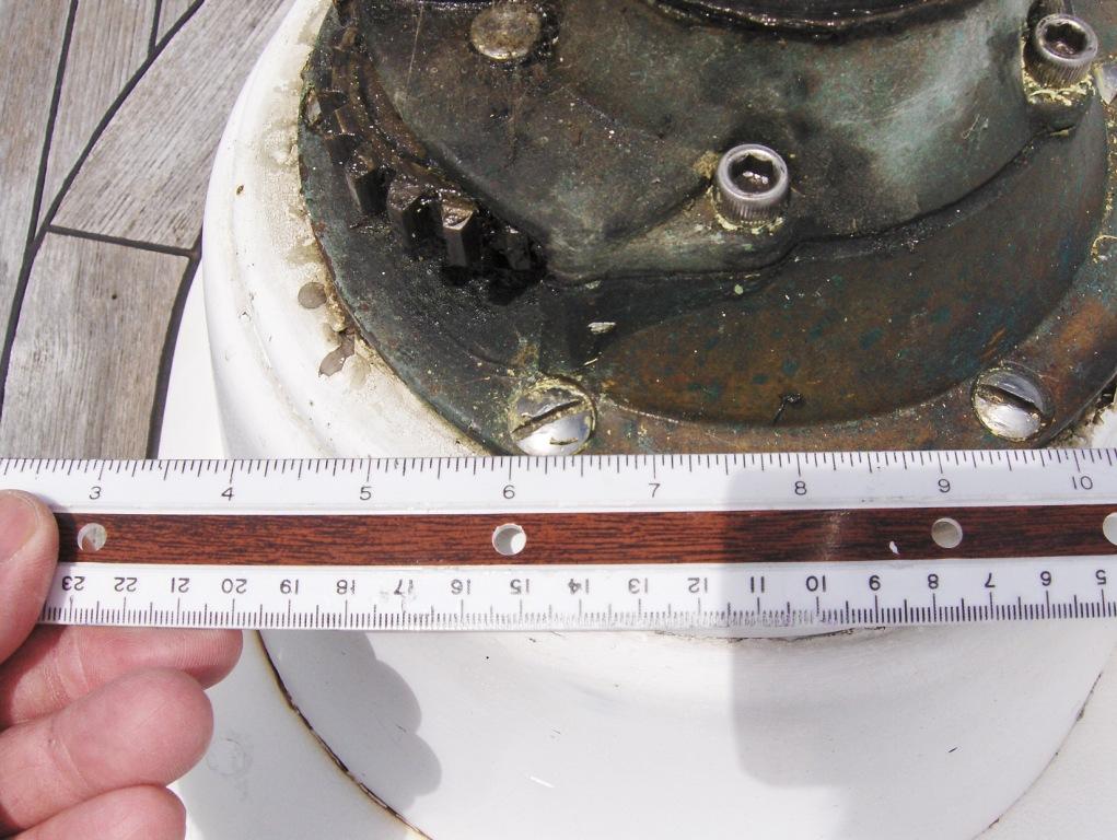

    Last of the pictures.
    bolts4 shows bolt size and distance between them
    plate thick shows the top plate and its thickness of about 1/2 inch.
    I believe three of the screws are bolted to the top plate with nuts on the underside and the other three go through the top plate and are bolted to the turned-in flange on the pedastal. You can see the top plate is loose, but I am unable to pull it up so it must be through bolted....
    And, I'm trying to do this with regular tools since I'm just a regular guy, not a mechanic.
    Thanks again.

    Ah so ... they look like 5/16 slotted oval head machine screws. Are you sure they are threaded into SS and not aluminum?
    You might be better off removing the mount the winch sits on and see what is behind those screws. At some point you will need to remove that large plate to access the hydraulic piping anyway - if it is hydraulic.
    If they don't back out with a large screwdriver with a wrench persuader they might just twist off then you will have to grind them flat and drill but since they are so small that is no big deal, just make sure you have a good drill and bit and don't be afraid to get pushy and aggressive when drilling.

    It looks like an Alu plate that the winch is sitting on to me.
    The dried yellow goo around the screw heads is probably Duralac
    http://www.piplers.co.uk/1195/Dural...oogle&utm_medium=froogle&utm_campaign=pid1195
    It isn't bad stuff and if it was used originally the screws might come out once you can get them to turn.
    If you do as suggested earlier and find the best fitting screwdriver( even if you have to buy one) with a square shank also one where the handle goes all the way through you could try undoing the screws while someone else gives the top of the blade a few knocks with a hammer.

    The mounting plate on which the winch sits will not come off. That is what makes me believe some of the screws holding the winch go through the mounting plate and into turned-in the flange on the pedastal.
    And, BTW, these are bolts with the threads all the way up to the slotted head.... Drilling them out (over 3 inches) would be pretty impossible.

    Got 'em! Three of the bolts succumbed to propane heating, ATF, and several blows on the screwdriver with a hammer. These three, situated towards the center of the pedestal, were only screwed into the top plate and also had nuts on them. The other three bolts, screwed through and into the top place AND the turned-in flange of the pedestal, absolutlely would not budge and had to be drilled out. It took several cobalt bits from Ace and a rented Bosch drill, but I eventually won.
    Just to be clear, the top plate and the turned-in flange have threaded holes; then the bolt has a nut on it as well. The boat is a Swan and built very well.
    The rented drill was an impact drill but the 'impact' feature was not useful since the bolts would not turn and the impact function only works when the drill is turning.
    Also, I am now pretty certain the top plate is aluminum.
    Thanks to everyone for helping.
