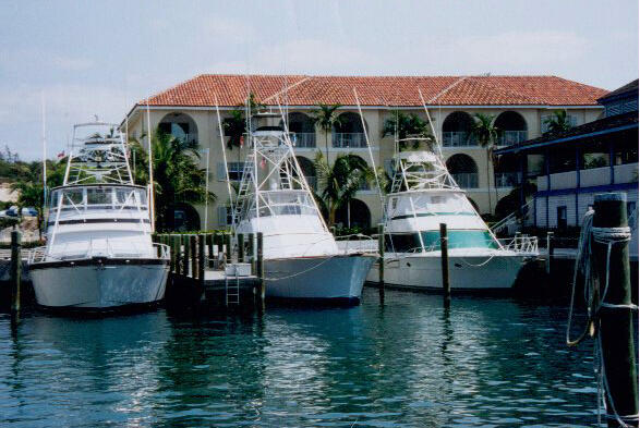

    Also, the 62 that is broadside on the site, I am 98% sure that is Narwhal that I was referring to. She is a whale! Very clean and well built. She was renamed Interconnect and a gaudy interior put in and now offered at over $1M still on original 12MANS I think.
    I attached a photo of Narwhal head on. Love the beam. This was before the blacked out antennas and KVH satv on top.
