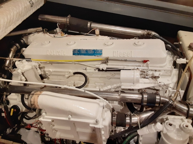

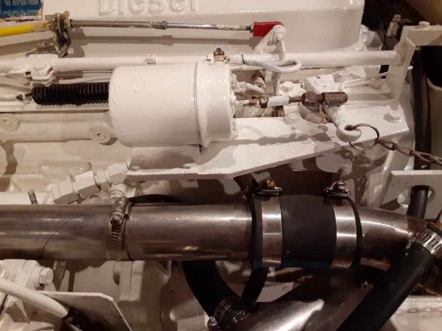

    6-71 DD stop solenoid

    Where did you get the S/S tubing? That's nice.

    Ok..figured it out thanks to you all...the arm that comes out of the solenoid has a rod with a ball on the end that goes into a socket attached to the arm...the socket attachment wore out and the ball fell out...what is that ball and socket contraption called? Temp fixed but want to do it right!

    And yes, where did you get those ss pipes? Sharp looking!!
  17. chesapeake46
    chesapeake46 Senior Member
    Jul 26, 2009
    1,781
    Just finished painting them for the second time in 25 yrs !!! I made the tubes from process pipe and used the old ones as patterns, also about 20 yrs ago .
