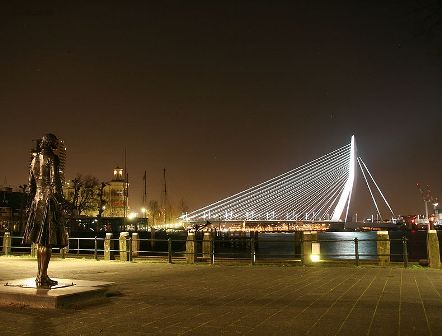

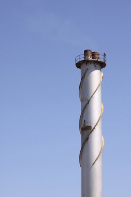

    It could also have to do with "eddy's": vortexes which release at a certain frequency. If this frequency coincides with the eigen-frequency of the antenna (which is function of the length), you can get resonance.
    They had this problem on the Erasmus bridge here in Holland, and it's also a frequent issue on chimneys. On the Erasmus bridge, they had calculated this effect, but initially they didn't take into account that the shape of the cables changes when it's raining (more wing-like).
    The solution could be to wind a rope or something in a spiral shape from base to top. This has an effect on where the eddy's release and could help your problem.
    If it doesn't help, at least it wasn't very costly to try it.
