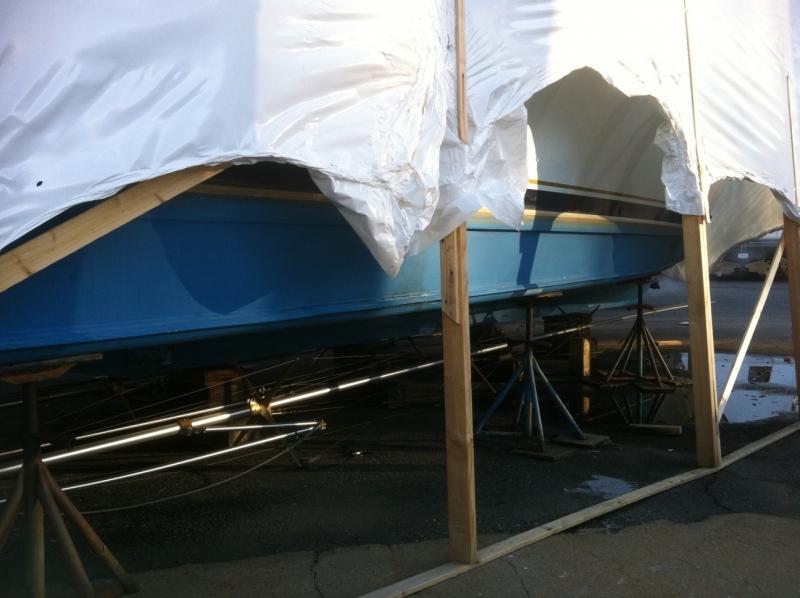

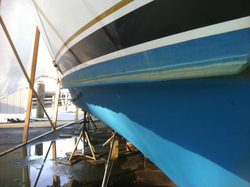

    Rails
    I installed the rails on my 77 42. One 9 ft section at the chine and I ran the rail from the chine to the aft end of the boat. It made a big difference knocking the spray down. I stopped alot of the following seas zigzag as well.

  10. shawn
    shawn New Member
    Feb 13, 2006
    126
    old saybrook ct
    pictures

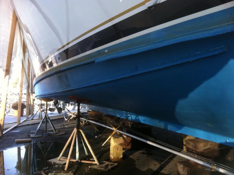

    Can you take a pic out away so i can see it from the side profile... I think i do see what is going to be in our future. Who did you use to supply the rails
  14. shawn
    shawn New Member
    Feb 13, 2006
    126
    old saybrook ct
    Spray rail
    This is the best I have until I take the cover off on another month.

    I did not pickup speed with them,which the company was suprized. I had the prop guy out in the boat he said you have done all you can do speed wise. I cruise at 24kt on the pins 29-30kt I did lift the boat higher out of the water. I have seen the before and after pictures. It cost @$1,200.00 to do the whole boat. It was a bit of work to do, you have to grind the botton paint of to the glass so the glue will hold on. They made a difference with the following seas. In a head sea it knocks some of the spray down. If you run in 4 to 5 footers you are still going to take alot of water over the bridge. My wife noticed a beter ride coming back from Block in 3 to 4. My fishing crew fish on a 46 Post a lot and they love the ride of my much better. My main purpuse was to get a better ride in a following sea, which it did!
    If I went to buy another older Post I would put them on again.
