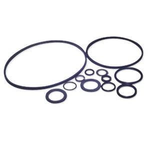

    May I also recommend a few sets of Separ seals and gaskets. They are rubbish for seating in, being square in shape. Most of our Owners/Skippers ask for the filters to be changed to Racors.

    I wholeheartedly agree about switching them to racors. I don't know which I hate more, the Separs or the old Dahls.......LOLOLOL Plus the Separs don't have a lot of surface area compared to a racor.

    :D:D:D Oh boy, I'd forgotten about Dahls!!!!!
    So easy to change at sea.
