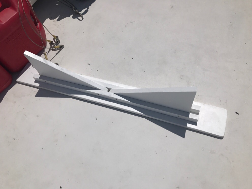

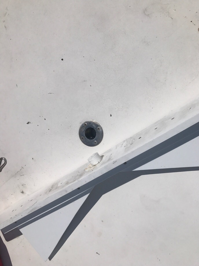

    I can find the pic of the first sets I made which just sat on the deck. These I made for a jetski but in two separate pieces and I built in a nipple underneath to fit in the SS fitting that was already on deck. Lazzara had a set of SS tails which could be used either as a cradle or moved as stern railing
    The jet ski is tied to D pad on deck with SS ratchet straps
    The key is to have the straps at an angle and not vertical which doesn't prevent lateral movement

    Looks good Pascal. We do have a wave runner and thinking about putting next to the tender, but not permanently. Like the idea of unattached removable cradles with nothing fixed above deck level. Thanks for the pics.
