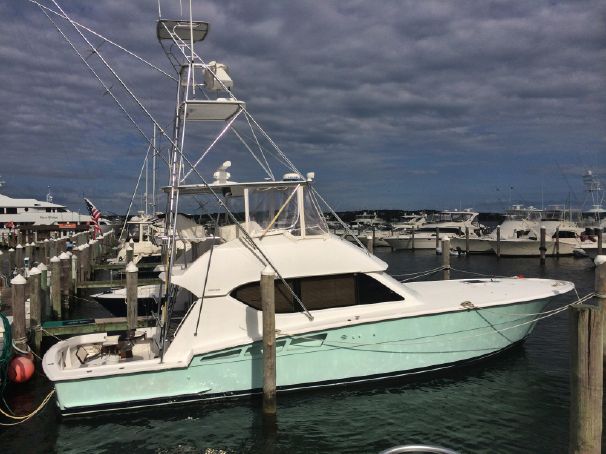

    Now this 50 Hat was nice all the way around but its the healm thing and on some like the Albin 36 TE the galley and salon are side by side and just an l berth dinette for relaxing is not gonna work but she is so beautiful.
