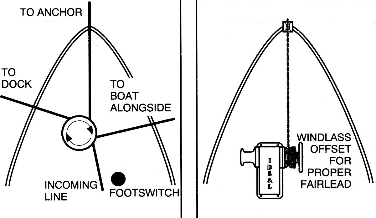

    On smaller boats, like the OP's 62' Sportfish, Windlasses do not have a brake like they do on large yachts. The Lewmar, Ideal, Maxwell and others do not have a brake like you see on 100' + yachts. You have a drum that has a nut on the top of it (or fitting for a sailboat which handle or nut for a wrench to tighten or loosen for tension on the drum to allow slippage (like a brake but only locking the drum to the windlass) if the anchor gets stuck and allow the chain to slip before breaking the windlass or bow pulpit. You do not loosen this to drop the anchor, if you did the drum and tool used would turn at whatever speed you let tension off at (possibly very fast and break your arm) and you would have no way of slowing it down. You indeed use the windlass motor to let out anchor chain and retrieve it. Think of it like a drag on a fishing reel. The nut on the top in the picture is not to be used to lower the anchor or as a brake in the sense of the windlasses you're used to. The pic below should be the windlass the OP has. As for putting a tool near the windlass that would be very smart to do, but on small boats like we're talking about, the only place to mount it in a yachtie way would be in the anchor locker and it would be a corroded mess in a few months in there.
    http://www.idealwindlass.com/images/new/BHW.JPG
  2. K1W1
    7,453
    I would suggest that instead of writing how you think that Windlass works in the photo you spent some time either using one or seeing one used.
    In that photo the gypsy ( thing that handles the chain) will be driven by the capstan via a clutch or some sort on the simplest it is a cone type connection.
    If you loosen this connection the chain will pay out if the whole thing is not gummed up with crud and has never been maintained.
    Before you bite my head off think of this.
    If I am wrong - How would you haul a line with the capstan while docked with the chain( a feature shown on the Ideal website) still wrapped around the gypsy?
    Also if that is the one being referred to I would say if that motor got swamped anchoring would be way down your list of priorities
  3. Capt J
    14,896
    You're wrong. There is no clutch to let the chain free fall. The Capstan is generally not used for docking. It is used to anchor rode.....you wrap the rode around the capstan and use the motor to bring it in, then when you get to the chain it falls onto/into the drum. It is VERY common for boats under 80' to have a combination of rode and chain, not all chain. It is also very common for the anchor to have a safety chain/line or holder, so if you wanted to you could pull the chain off of the drum and set it on the deck and then use the Capstain to haul docking lines, but we don't do that in this neck of the woods. You can see the safety holder foward of the windlass in the photo. Here is a photo of a new Lewmar windlass commonly used on 50' boats. If you notice the star hole is offset and turns with the drum, the lewmar drum is capable of retrieving both chain and rode.

    I ran a 70' yacht with the same ideal windlass that Capt J's picture shows. K1W1 is correct on the working of the windlass, but the clutch that is engaged by tightening the top nut is flat, much like an automotive clutch friction disc. It is between the capstan and the gypsy. The capstan is joined to the axle with a woodruff key, and the gypsy has the potential to freewheel when the top nut is eased.
    Danville Tim: I had the same problem with the windlass in that the clutch would not release either surface on the capstan and gypsy. It simply "stuck" to both surfaces and had to be broken free with a cheater bar prying against the chain between the anchor and gypsy. The Maxwell I had used in the Pacific Northwest this summer had a similar issue, but it would release once the anchor weight went past the bow roller by paying out chain with the foot switch. The Ideal windlass was a 120 volt AC motor with no reversing, so it had to be manhandled. Incidentally, we once snapped the axle shaft on the Ideal, possibly from enthusiastic anchor setting :(. It was a real pain to pull up 150' of 3/8" chain and a CQR anchor by hand. Always use a snubber!
