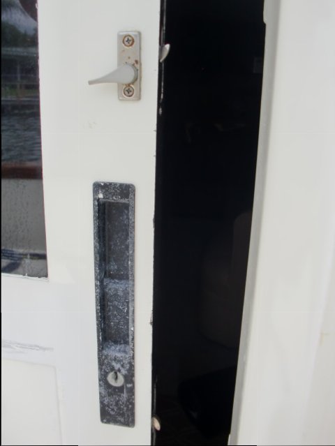

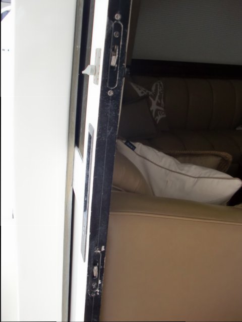

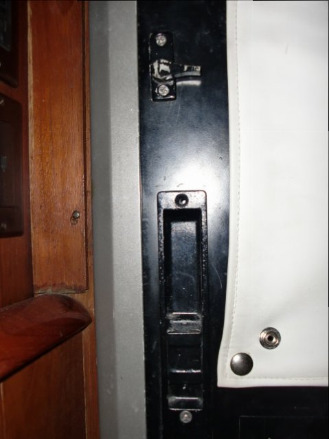

    Has anyone had the pleasure of working on the sliding salon door on an Ocean Sportfish? I need to remove the door locks. Any information on how to remove the looks or who made them is appreciated. I have a 1992 42'; from pictures online, it looks like all the salon doors where made the same on all 42, 46, 48' +/- 3-4 years.

    Just to let you all know; I found the manufacture for the door locks: Adams Rite Manufacturing Co.
    Now all I need to do is find out who made the door.
