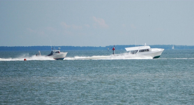

    The workboat that I happened to be on was a deadrise style but used more for towing and made of aluminum. it had a 8V92 in it @ about 735 hp.
    It would really leap out of the water.
    This is the only picture I could find of it. Trailing.
