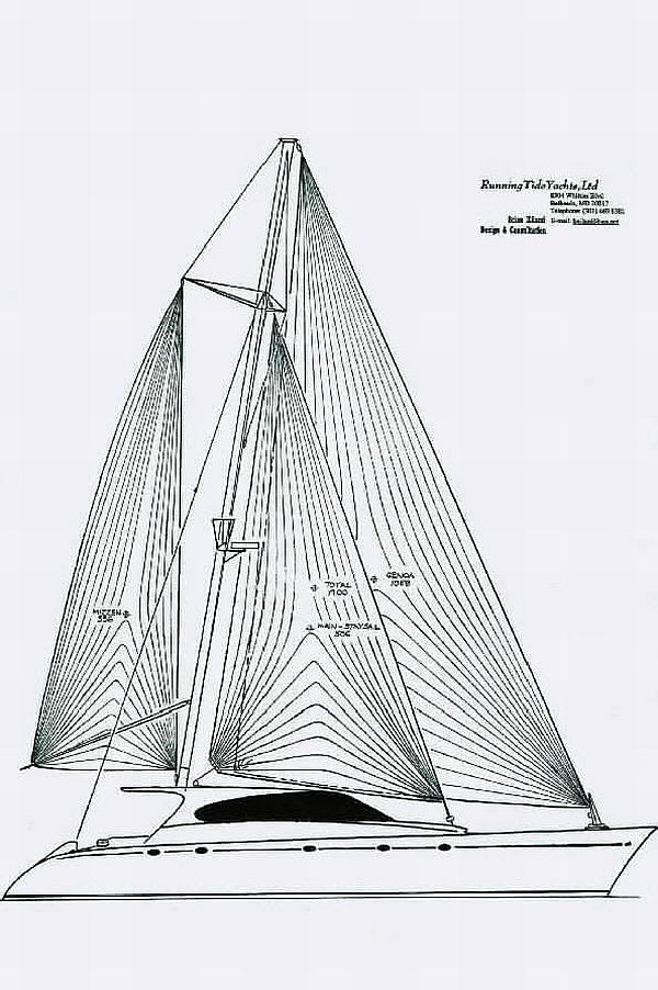

    Just a few generalities here. The multimast rig is going to have more aero-drag force, so its windward ability is compromised...but ever so slightly. If one makes an honest accounting of the time he spends beating hard into the wind verses the other points of sail, particularly aboard a CrUISING vessel, he will often go for the 'split rig'. ...breaking those big sail areas of the sloop down into more managable sizes.
    A very popular way to sail a ketch in a reduced sail manner, is to reef the mainsail, or douse it totally, and then sail under headsail and mizzen sail. Boat can be made to 'balance' very well with just a little tweaking of the mizzen sail after the headsail is set to perform at its best depending on the course selected.

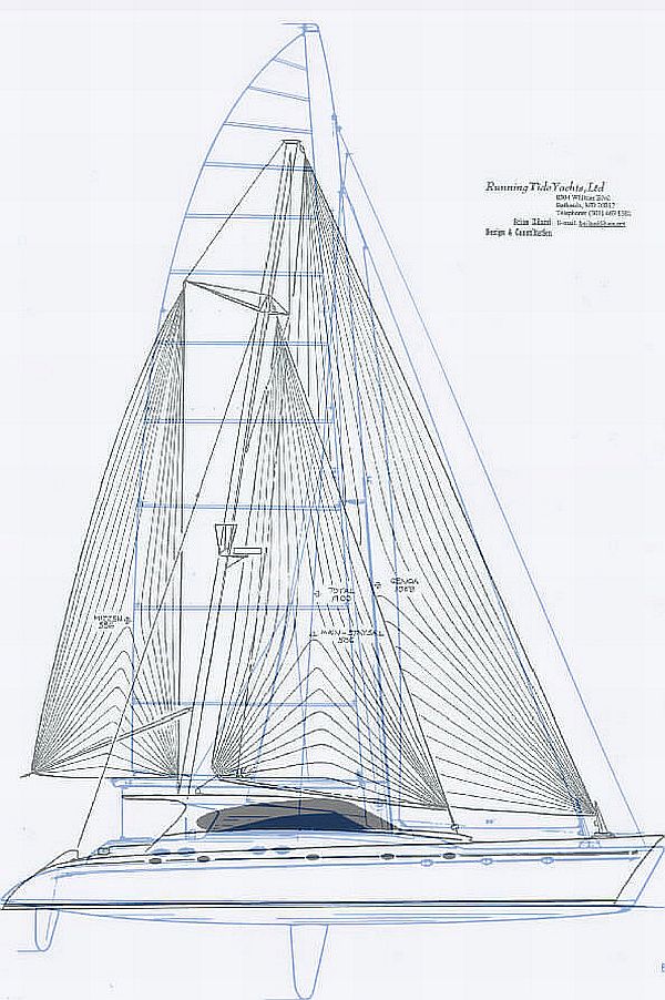

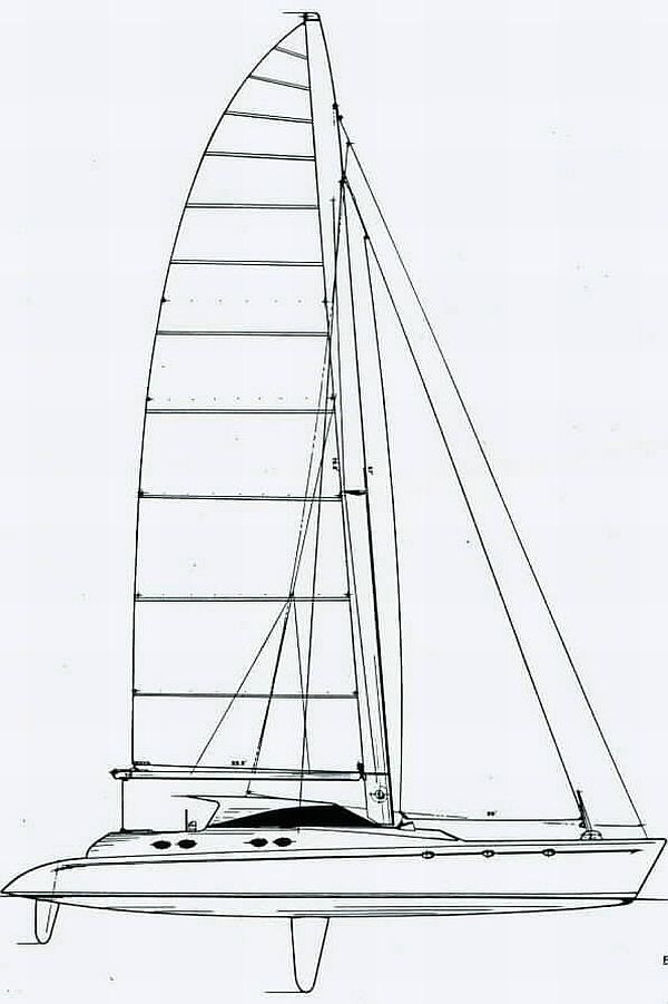

    I'm back to justify this rig design once more. I was made aware of an error I made in designing the original masthead backstay, but I have made a new design for my backstays.
    This rig really makes sense for the cruising sailor that tired of wrestling those big mainsails, booms, etc
