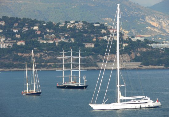

  9. Fishtigua
    Fishtigua Senior Member
    Jul 20, 2007
    2,935
    Guernsey/Antigua
    To give you an idea of the size of Mirabella's rig next to Falcon's.

  11. Ward
    Ward Senior Member
    Jan 18, 2010
    278
    Vancouver BC
    I was curious, so I looked it up:
    Mirabella V:
    Length 75.2 m (247 ft)
    Mast height 88.5 m (290 ft)
    Displacement 740 tonnes
    Sail Area 2385 m² (25,675 sq ft) (main+working jib)
    Maltese Falcon:
    Length 88m / 289ft
    Mast height 58.2m / 191ft
    Displacement 1,240 t
    Sail Area 2,400 m² / 25,791 ft²
    So even though Mirabella V is shorter, her air draft is more than 50% greater than Maltese Falcon's.
    And, as pointed out in the following post, there are other factors, so I edited in sail area and displacement... The comparisons are interesting, and you can see some of the tradeoffs, but not enough to generalize into any rules or guidelines, they're two very different yachts.
  12. NYCAP123
    11,210
    Check what they're pushing also: 740 tons vs 1240 tons.
    Lots of calculations involved.
