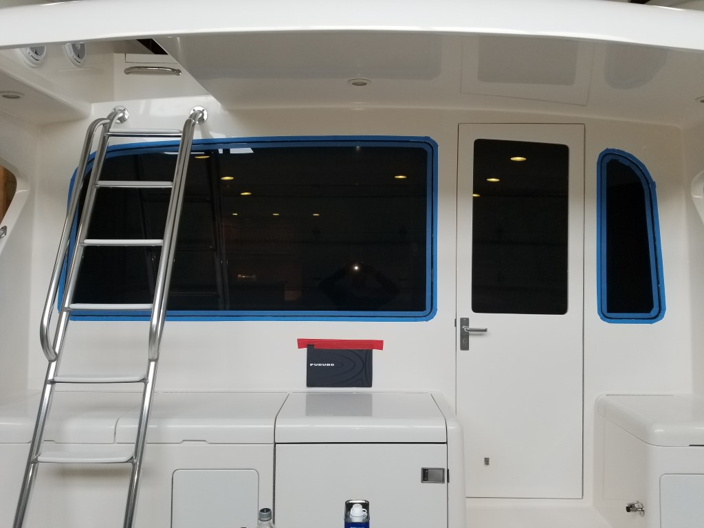

    Decided to recaulk the salon windows on the Sportfish. They were beginning to leach black during washdown on occasion and you could see the aging in the caulk after a decade. Trying to decided between 295 and 296. Any thoughts?

    Thanks CaptJ. I already removed the needed caulk around the rear windows in the cockpit and have them masked off so I will pick up some 295. The existing caulk was in need of removal with the shrinkage and cracking so if I can get a fresh bead around all the windows I should be good for 15 yrs no problem now that boat is stored inside.

    After careful consideration I feel good about 295. 296 would be ideal and absolutely what i would have used had I been bedding the windows but I am simply pulling old caulk out of the seam and giving it a fresh edge. The fact that 296 only comes in the large sausage packaging tells me it is more a OEM boat builder product. I didn't want to buy a specialized caulk gun for this simple project. Some guys use 291 but I think 295 finishes with a smoother edge and will adhere better with existing 296 that Cabo installed windows with. I did the back windows a few days ago and both came out great. Pulled the existing caulk out of Port and Starboard salon windows after work this evening and will mask off and caulk when time allows.
