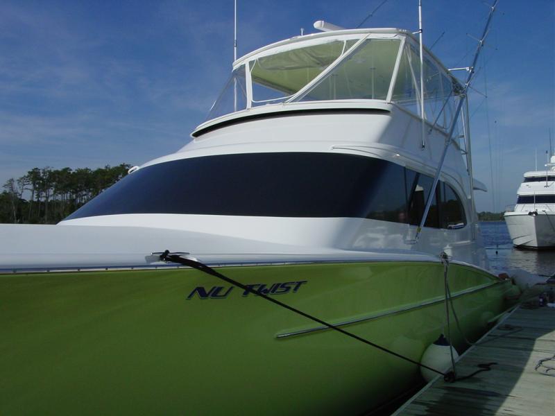

    Seams themselves shouldn't leak unless the stitching is not close enough. More often zippers are the culprit on panel edges and smile openings. Most good canvas shops will sew flaps with velcro over seams and openings especially on the front of enclosures where wind will drive water through zippers. Also make sure the tracks are caulked to the hardtop and bridge structure.
    I know it isn''t zoomed in but you can see this enclosure has flaps covering the smile and corners on the front and is very dry even on rough days when there's a lot of water in the air!

    Nice boat.
    If you have time, post a few pics.
