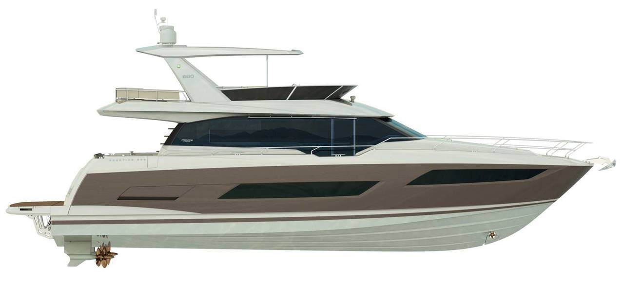

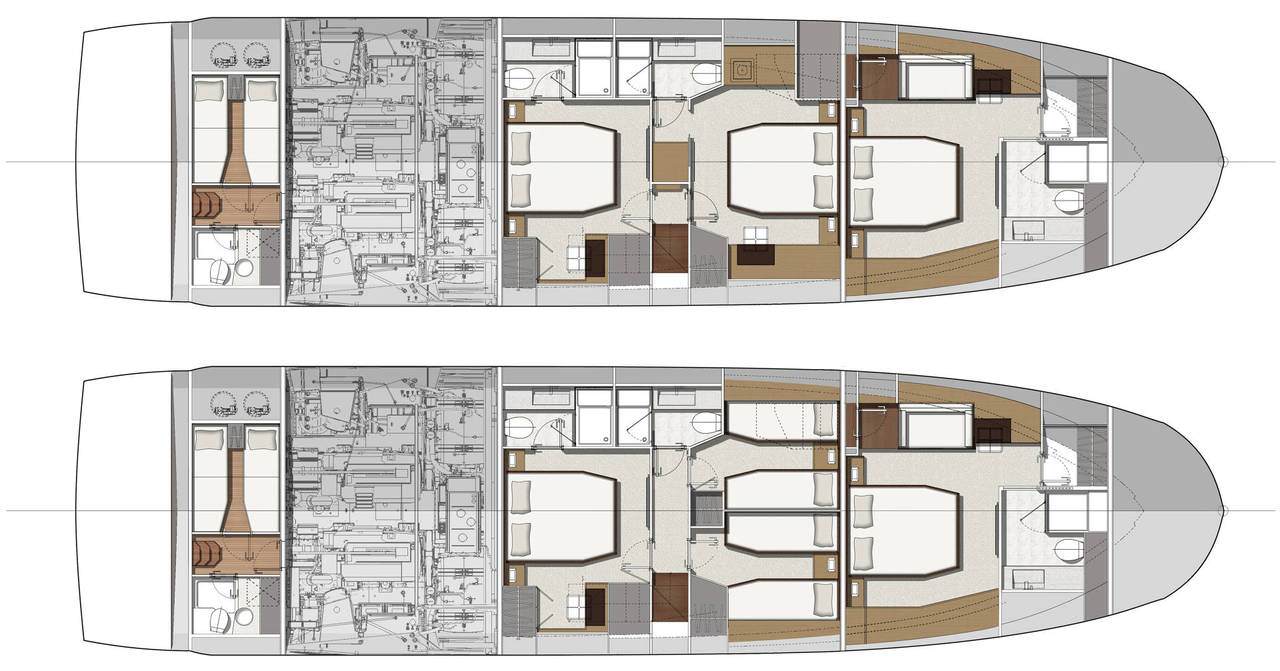

    Talked to my son in law this evening. He knew already about the different props available. The Prestige 680 with twin IPS 1350 is equipped as standard with the "normal" props for a good balance of top speed, economy and acceleration. The "high performance" props are giving a bit more top speed with lower acceleration and higher fuel consumption. He will take the standard props, as he is not interested in the last Knot of top speed. They cruise a lot on rivers and other speed restricted areas but he likes the better acceleration. He has driven both the IPS 1200 and 1350 already. He says, there is a difference in performance. But the main reason for the new boat ist the different lower deck layout. His present boat has tripple double cabins and the new one will have two double and two twin cabins. Both with one additional crew cabin. A better setup for two families with two kids each during a weekend cruise.
    But if son Nr.1 goes for a larger boat with permanent crew (his license is only valid up to 24 meters LoA) and still wants to see 40 Kts, I will strongly advice him to go for the Q-SPD drives and MTU engines. My choice would be a Pershing 108 with tripple MTU 16V 2000 M96 L engines, if they could be talked into those surface drives. I would definately not go for Arneson drives and not again for a fully custom one-off. To much trouble, far to expensive and it takes far to long to build it. Too bad Delta Power Boats is not ready for and with the 105.

    I don't think the Prestige's are exactly a fast hull or fast boat, so you're better off with the standard props.

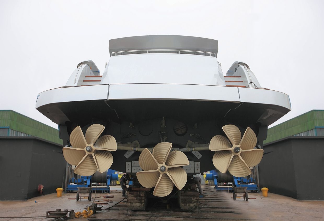

    The 115 is a totally different animal with its MTU 4000 engines, its KAMEWAs and the center booster with jet turbine. But a really fantastic boat.
