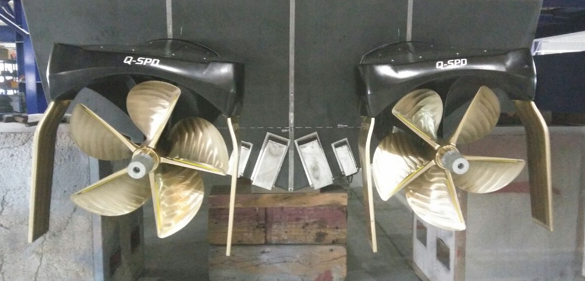

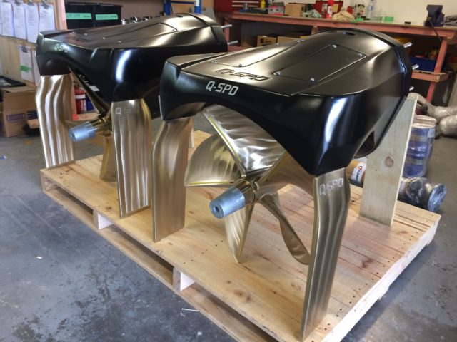

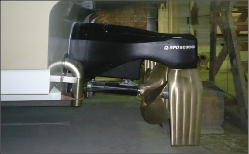

    My son is very happy with his quad IPS setup. He only wants more speed which the Volvo IPS pods are just not build for. Around 35 Kts seems to be their limit. As far as handling at all speeds, close quarter maneuvering, docking, efficiency and comfort of ride, IMHO nothing can beat IPS in that size, as long as You have a boat that was designed for that system from the beginning and is equipped with interceptor stabis additional.
    For higher speeds, if You do not want conventional shaft and prop, You have only the choice between surface drives and Water jets. Waterjets are awfully inefficient at low speed but work nicely at their design speed. And low speed maneuvering and backing into a slip is no real fun either. With surface drives, You will get most likely the highest speed for a given engine package, depending on the type of surface drives You are choosing.

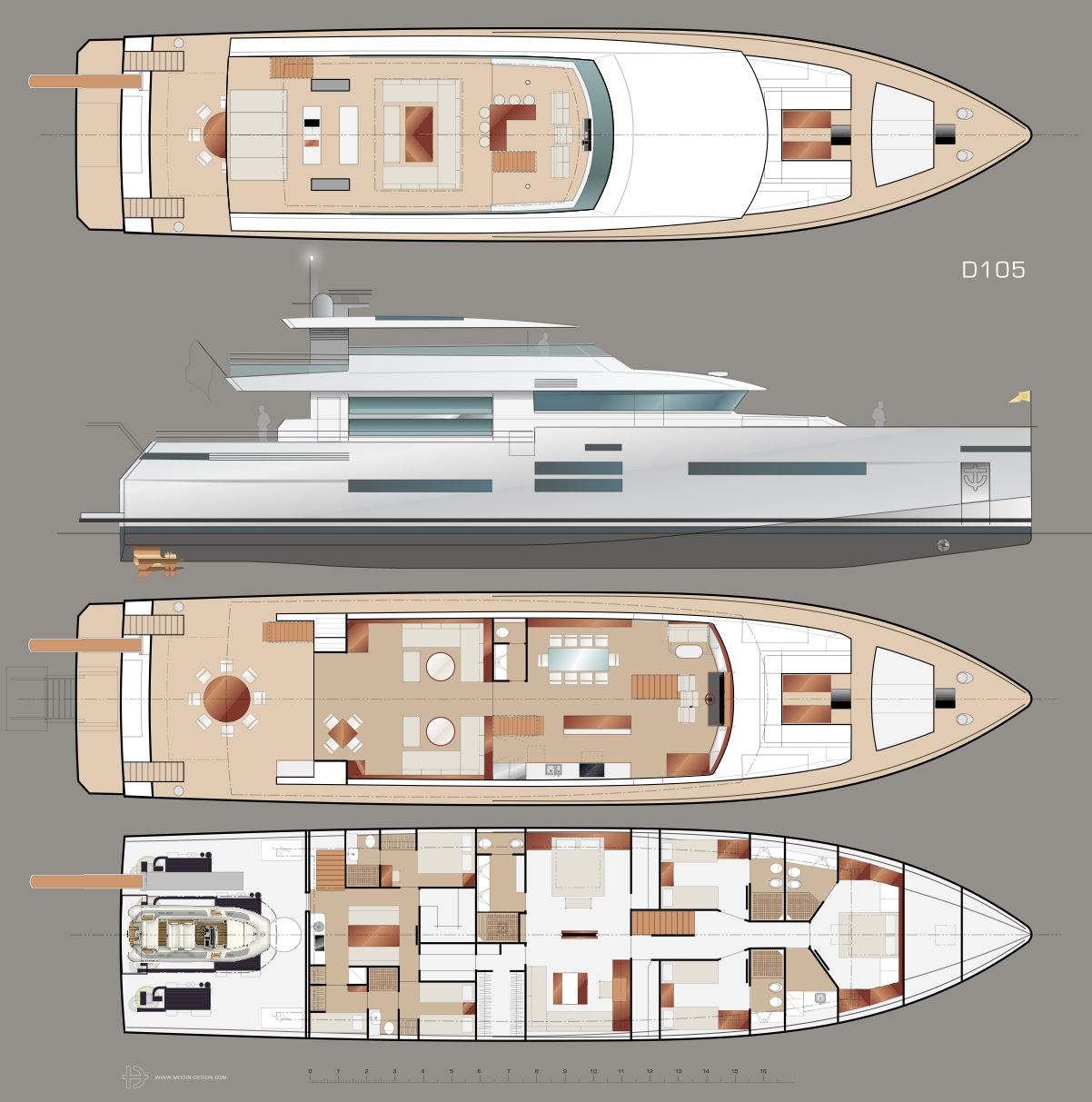

    My son and I have tested some speed boats in the 80 to 100 ft class with waterjets and Arneson surface drives a few years ago. Also he got addicted to those nice Rooster tails at speed, he bought the quad IPS, as strongly requested by his wife :). She was afraid of that wave pattern and that roaring noise.
    But now he wants to go bigger and faster. With quad IPS 1350, the size limit would be at around 120 to 130 ft and still with max. 35 Kts. Lars Modin has some very nice designs in his portfolio at 105 and 130 ft. I personally think, 35 Kts are more than enough, especially with all the advantages You gain with IPS. I am still trying to talk him into one of those.
    We do not prefer the Arneson drives. My son has some jetty neighbours in the Med with Arneson drives (Pershing). They are either not used at all or have a lot of trouble with their propulsion train. But with 4 non steerable surface drives like the Levi drives or the Q-SPD drives, the props ventilated with the exhaust gasses, one could go up to 165 ft LoA. With quad MTU 16V2000 M96L and 4 Q-SPD drives even a Mangusta 165 E could easily make 40 Kts cruise.
    These are pictures of smaller variants but bigger ones are available on request for up to 3.000 HP each. I am sure those drives are far less trouble prone, cause less maintenance and are even cheaper to buy than Arneson drives.
    With the Corona travel restrictions, I have most likely some more weeks to convince him. I would like to hear the opinion of Lars about IPS in general and especially about a larger IPS boat with quad IPS 1350 versus
    one with surface drives, versus conventionell shaft and wheel.

  16. AMG
    5,392
    Hello my friend,
    First, with IPS/1350 they have props for speeds up to 42 knots. With the D8/800 the limit is 40 knots and with the D6 range up to IPS/650 you today have props for speeds up to 50 knots!
    The 105' boat with quad 1350 was intended to be built in carbon fiber as our other large boats and with the same approximate performance of top speed near 40 knots and cruising 30+.
    At the same time as I did this design, Volvo Penta presented a hybrid solution, with integrated electric motors, why the project was waiting for more info. Since then this hybrid has vanished from their map and we don´t know if it ever will be launched or be replaced with a new concept. Whatever, a semi electric drive would be the perfect combination for the IPS drives. Especially compared to water jets or surface drives.
    Conventional shafts are of course a good solution on displacement and semi displacement yachts, but not that efficient compared to IPS between 20 and 30 knots cruising speed. As always the decision must include your personal preferences on speed, vs range and cost...
  17. HTMO9
    HTMO9 Senior Member
    Jan 13, 2009
    1,681
    Hello Lars,
    Great info Lars. My Volvo IPS knowledge seems to be not up to date then. Your connection to the Volvo guys is definately much better than ours as normal mortal end users. When talking to VP Germany in Kiel, they only told us to talk to the boat manufacturer for more details.
    I will tell my son in law about the higher speed props for his new Prestige 680. His dealer did not say anything about them. He probably did not know either.
    The 105 quad IPS is a perfect design Lars. Will Delta Power Boats still build it?

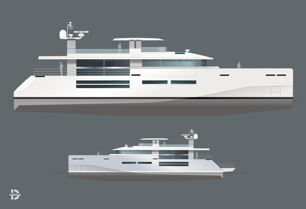

    What kind of propulsion did You plan for the 130?
    HTMO
  18. AMG
    5,392
    The 130 was intended for pods or shafts, but just semi displacement with cruising about 12-14 knots, a floating beach house.
    The 105 could be built by Delta Powerboats if we could sell a few before making moulds, but we are not actively marketing it now.
    Instead we are making moulds for a big catamaran that can be ordered in different lengths, from about 24 up to 40 meters with the same beam of 13,6 meters. The first built should have IPS...
