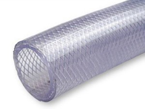

    My experience with leaving the AC running when not onboard, was on a 2 year old Dutch built yacht with a 3 compressor system and a seawater pump of at least 3000 GPH. It was connected with a reinforced 2" hose that burst when we were for lunch in the same port. Luckily we were back within about 30 minutes so it was "only" a few thousand litres of sea water in the engine room to pump out... plus cleaning it all with fresh water...

    Normally if a hose burst the compressor will trip the high pressure switch and the pump will stop. Unless the builder cheaped out and hard wir the pump.
    I woudl hope that a boat which requires 3000gph to cool its compressors has at least two to three times this in bilge pump capacity :)

    The hose was not totally cut off, but had a 4" long split where perhaps half of the water was spraying out so the pressure was not zero. And of course there were both an alarm and a pump going, but the automatic pump was not enough, so we had to start a bigger one manually...

    Those hoses don't just split like that... I was probably damaged during install with poorly handled knife.
    Design flaw... bilge pump capacity should be significantly higher than any air con pump, water maker etc

    I don't believe that hose in the photo is for use below the waterline, even though it is somewhat reinforced.
    After another look it looks like it is suitable for pressurized potable water systems, but I would not be inclined to use it as a raw water a/c circulating hose.
