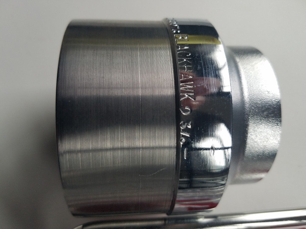

  3. CaboFly
    CaboFly Active Member
    Aug 24, 2018
    285
    Seattle
    I would also add the Socket is 2 3/8 12 pts. 3/4 drive. Shortened on both ends. And outside dia. Turned down. I am fortunate to have a father who is a retired machinist.
