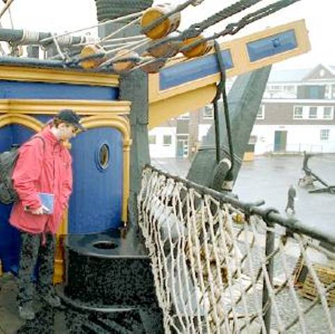

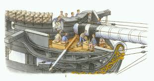

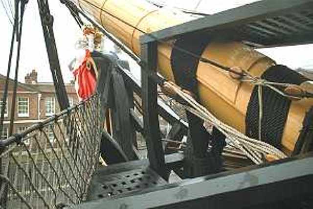

    But the absolute most reliable ship toilets can still be seen on the famous British warship HMS Victory in Plymouth. First picture, one of the two famous "hole above the waves" for the senior NCO and second the "designated space" on the bowsprit for the ordinary seaman. And you guys are complaining about a few rubber seals. Aren't we spoiled today?
    And there was only one more enclosed place for the officers. Btw. the HMS Victory had a total crew of 821 men!! And no bathroom!
    And do not complain, boats were only invented to keep the maintenance and repair companies busy. Our old Master Shipwright always said, a boat is just a hole in water for throwing your money in :D.
