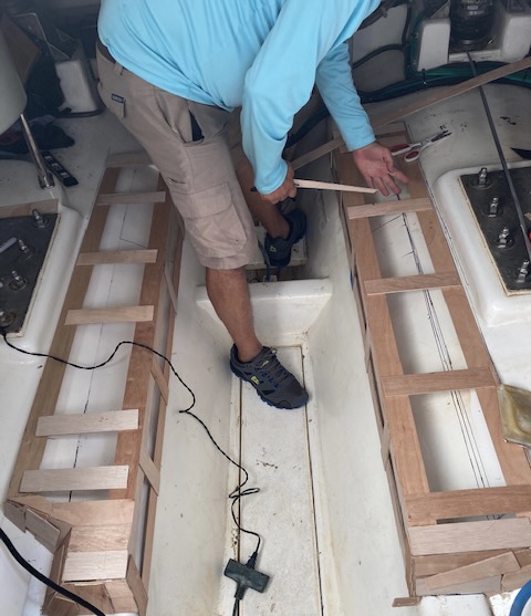

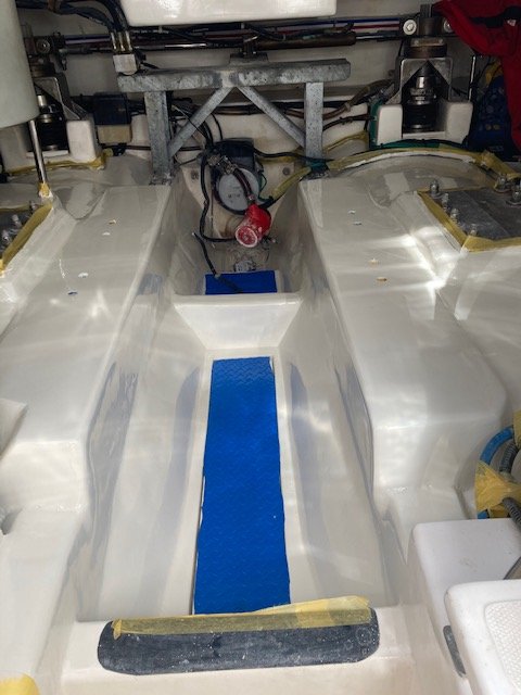

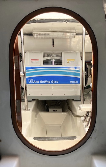

  11. KoffeeCruising
    KoffeeCruising Member
    May 27, 2018
    99
    Fl

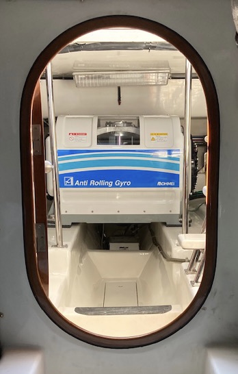

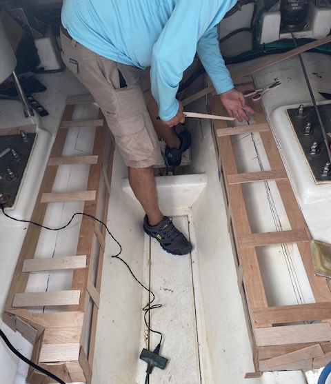

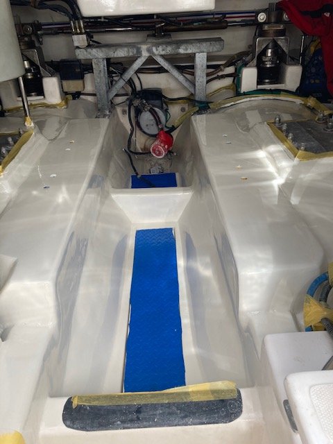

    I upgraded my 54’ Flybridge with an ARG (anti roll gyro) installed by American Spin Doctors. Air cooled vs water cooked like Seakeeper. So far so good; low speed, anchor and chop its great. Beam swells it works ok; you still get the first swell but it tempers the resulting roll … until the next swell. I love how you can feel it counteract the roll.
    I’m enthusiastic about it. It’s a wife /guest pleaser, it should be a good resell feature, and installation was a generally straightforward We built up the stringers in my lazeretre and installed the control box in a cabinet next to my stereo equipment.
    97BE4ECA-F727-4B4E-B051-D1670652BF99.jpeg C34D1973-02D7-4704-A65D-0AF82D9500A4.jpeg 408A7D08-FA80-441A-968D-BAE1AFB8F31A.jpeg
