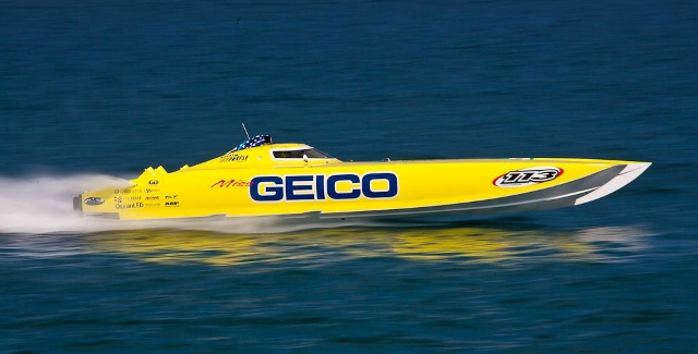

    Then my daughter in law was lucky, my son did not have the demo ride on your boat. With the performance of your boat, he would have bought most likely a Pershing. The main reason, he went for the quad IPS, was the fact, that the ladies (his wife and his mother) were scared by the demo ride.
    After buying the much lower performing IPS boat (35 Kts WOT, bearely 30 Kts at MCP) he was talking about buying an additional gas turbine powered very fast boat like "Miss Geico".
    Only the immediate offer of an pending divorse by his wife, prevented him going that road :).

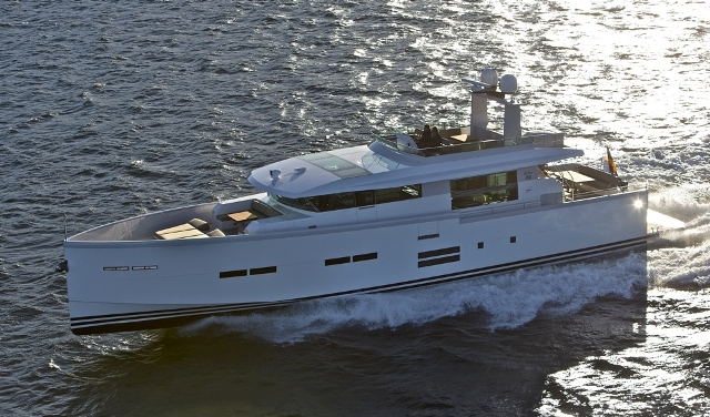

    The second IPS contender would be the Delta Powerboat, Delta 80, tripple IPS 1200 and by far the lightest of all above mentioned boats, due to its fully carbon vacuum-infused building process. Top performance, great design and as it looks from distance, it rides remarkable smooth and dry. High end as far as quality, design and final price is concerned but calculating its overcomplete standard spec, still reasonable.
