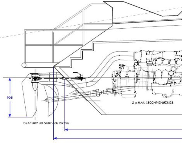

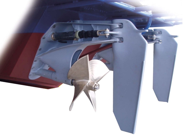

    My other son and I are looking into a new (very fast) planing boat in the 80 ft region for him with surface drives. Having looked at and tested the Arnesson type surface drives, I found an very old post about Seafury Surface Drives from Down under. They look much simpler as far as maintenance and operations are concerned.
    I would like to hear the opinion of our fast boat specialists about this system, especially in a multi engine enviroment (i.e. 3 engines). Would be very nice to hear from somebody with personal experience (Reliability, performance, Noise level). We have no other knowledge than some pictures, videos and their website.

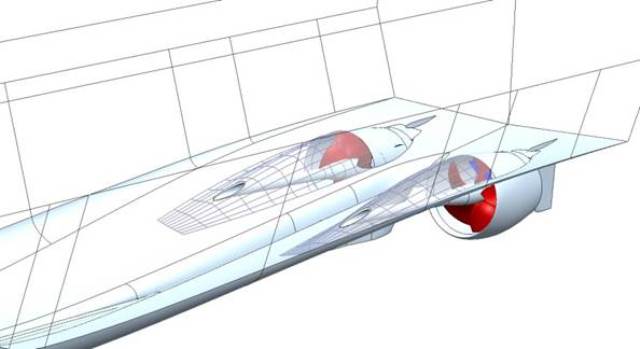

    I'm not familiar with Sea Fury either, but at a glance they've taken an interesting approach by ventilating the prop with the exhaust. Some thoughts...
    1. The direct drive shaft should prove reliable and low maintenance, but the thrust angle appears severe in the drawing.
    2. The drive is a fixed X-dimension, so you will not be able to induce trim, an important element with surface drives to achieve plane.
    3. Arnesons steer with vectored thrust, which provides a limited range. Not the most maneuverable, especially when backing down a slip. It appears the Fury drive will operate in a more conventional prop and rudder form, however I question the maneuverability based on the X-dimension of the prop. It looks like a good portion of reverse thrust will be met by the transom?
    I haven't looked at their website, so maybe I'm missing something. Correct me if my initial thoughts are off-base.

    The Sea Fury drive is asking for a specific stern angle of 45 degrees. By means of the angled stern, the reversed thrust is supposed to be deflected downwards by the stern and not against the stern. They advertise the astern performance as one of their biggest advantages. But the trimming issue is not really adressed on their website.

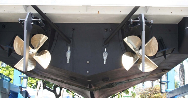

    We did test trial two different Arneson boats with twin drives and we were shown one with tripple Arneson drives with the opportunity to take the helm, while in the open sea. The tripple 108 ft AD boat was a beast and for sure nothing for a weekend skipper. The two other twin AD boats would have been something for my sons to get used to, as long as some able crew would be around for most of the time.
    One of the official sea trail skippers took the easy way, when backing into the slip. Prior backing in, he had his crew handing the transom lines to other crews on both sides of the slip and had them walk the lines to shore. Finally his crew pulled the boat into the slip with the aft mooring winches. What a milksop.
    Son Nr. 1 decided, to much bother and opted for the quad IPS boat. Never had any trouble with it (technically) until now (two seasons) and docking with the joystick is a no brainer. With all systems operating, my grandson could dock that boat (joking).
    But son Nr. 2 wants more speed, thats why we are back to either surface drives or KAMEWAS.
    I personally like the maritune (MTU) drives with the automatic trim system a bit more than the Arneson drives. The sea trail boat felt less noisy and more comfortable because of the always optimum trim of the drives. But I am sure, a professional AD driver could do almost the same with a manual trim setup.

    By looking at the videos of the Seafury drives, backing seems to be much easier than with Arneson drives. It looks like a very quick acceleration to plane and some pretty good maneuvering capability. But I have no idea about their serviceability and the support by the company, halfway around the world. But most important (and most expensive) this would require one more one off by a custom builder.

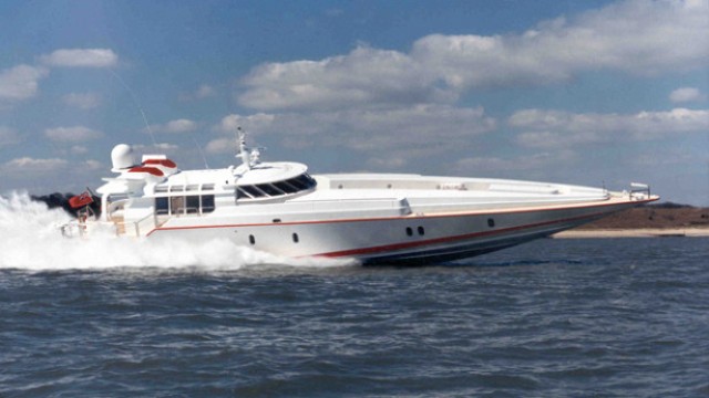

    I think the Seafury looks good, with few moving parts and low draft. But I guess they are like all surface drives, pretty useless in the 7-17 knots range.

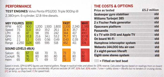

    Unfortunately there are no IPS configurations for cruising above 40 knots yet, but on the other hand, how often can you maintain a cruising speed over 40 knots with an 80-footer?
    My priority is the combination of high speed and long range/mileage. Have a look at these figures for the Delta 80, copied from Motor Boat & Yachting March 2014;

    AMG, you are running against open doors with me (old German Saying :)). I do love the perfect design of the D 80 and how it looks on plane. Her performance is more than anybody could want from an 80 footer. My oldest son would have bought her without hesitation, if we would have known about her, when inking the contract for his one off. Btw., he (or was it me ?) paid almost twice as much for his custom made quad IPS carbon monster.
    None of the Italian plastic fantastic with surface drives, we tested, was capable of sustained 40 Kts+. At MCP all remained in the upper 30 and the fluel flow was ridiculous. And 40 Kts+ in anything other than dead calm glassy sea was really painfull, both for the POB and the material.

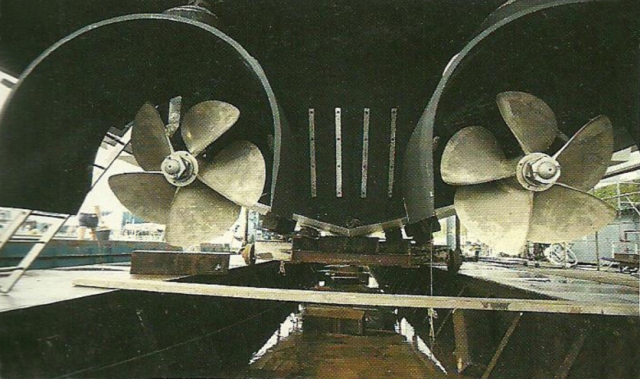

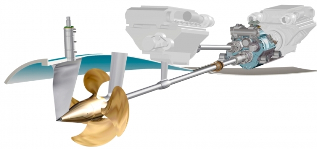

    If I personally would want to build a fast boat with surface drives, I would go bigger with tripple or even quad drives and some serious MTU engines. The Levi Side Winder Surface Drives look perfect for this type of boat.
    I was wondering about this stainless steel arches above the props. Dont they vibrate to death with this high power output?
    But I do agree with AMG 100 %. For any planning boat (except may be a sportfisher) up to 100 ft in length, multiple IPS would be my favorite. Above that length, one of the above or KAMEWA.

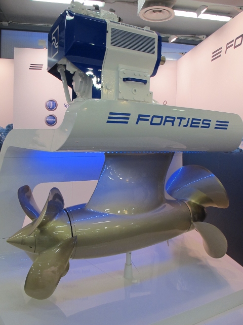

    Or may be one system, we have not talked about jet, the
    Servogear Ecoflow Propulsorâ„¢
