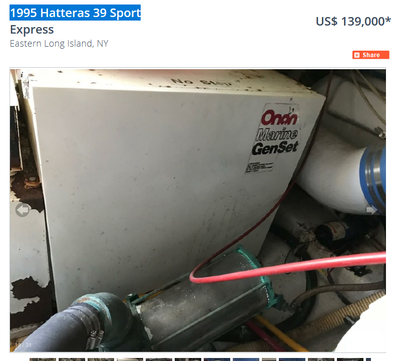

    See for example, a questionable shoe-horned genset install on a 39 Hatt, keeping the maintainers of the world busy. You could insert a picture for every builder, except maybe a custom, and highlight these type of issues.
