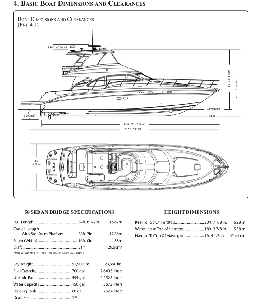

    Pros and cons of the 2006-2008 version of this model?
    I'm surprised the Powerboat Guide and other specs I've found says the boat is 58'0 or maybe 58'8" AOL... and maybe or maybe not including the big hydraulic platform attached aft of the molded-in platform... whereas USCG records show these being documented at 54-55'.
    Ditto surprise at published 16' beam specs versus documentation at around 15½'.
    Pros and cons of the MAN V8-900CRM diesels? (I think these are also labeled D2848LE423?)
    I suspect the earlier 800-hp version D2848LE403 in the earlier 550 model (same boat) were mechanical engines, so the "Common Rail Marine" version would be an updated electronic version of that block?

  2. NYCAP123
    11,210
    Model Specs LOA should not include add-ons such as swim platforms and bow pulpits. Individual boat specs will. That's your 3'-4'. The beam # sounds like rounding up.

    Yep, I thought most "LOAs" have gravitated toward only including swim platforms if they're integral to the hull.
    PBG doesn't usually round either direction, near as I can tell... although that doesn't suggest to me they're always correct. (PBG says 58'7" Length w/Platform and another on-line source says 58'8".) I'd suspect they're using specs supplied to them by the builders, though...

    Try this, but you'll need to add on the the hydraulic swim platform length as this only gives the std platform. But I believe the factory replaced the std platform with the hydraulic so it's not a straight add on, but a net of about 2' extra so a LOA 60' 8" +/-

    Forgot the molded in stern platform was an overhang, then the hydraulic back porch.

    I've seen those dimensions, but without the drawings. That illustration looks like it does already include the added-on hydraulic platform... A 55' would be right at the upper end of our theoretical sweet spot; a 58' starts getting on toward maybe bigger than deciding on the spur of the moment to go get lunch in downtown Annapolis. Have to think about that.

    Revisiting dimensions in the diagram...
    Looks to me in the upper pic that 54' 6½" is the length to the aft end of the original molded-in platform area... i.e., where the gunnels sweep downward to mate with the original swimdeck surface... That 54' 6½" correlates with the various USCG docs I've glanced at...
    And then the 4' (lower pic, and from doing the math) hydraulic platform is aft of that. And that correlates with the PBG "Length w/Platform... 58' 7".

    ranger42c your dimensional analysis is correct for a boat with the std swim platform, although the 54'61/2" is to the molded hulls transom the 58'8" is to the end of the std platform. With the hydraulic its is a bit longer (60') as the fixed portion is cut back to around 2' and the movable portion is about 4'. If you don't want the hydraulic platform and and associated extra length get the 2005 550 which is the same boat and hull w/o the hydraulic platform but a davit. There are a couple on the market with the 900's I believe if you like those. The hull was new in '05 and is different than the previous 98-04 hull, especially in that it has no balsa coring, it is solid and/or uses non wood cormat. I got the actual hull layup engineering dwg from sea ray. It is a very good sea boat. Demann is a character but a straight shooter and does very good work at a fair price. I still get parts (filters, plugs) and advice from him. Good people for sure.
