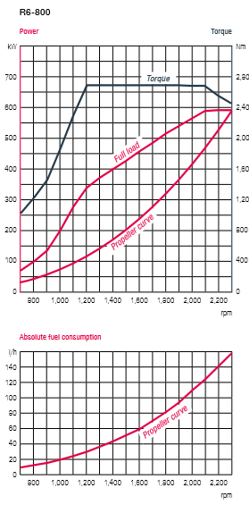

    Folks, I'm afraid you are talking of different engines.
    Afaik, the Rivarama is R6/800 powered, which is a completely different animal (6 inline cylinders, electronically controlled common rail) vs. the V8/800.
    Not sure about the Cabo, but in any case if you are aware of what the load is, you can't be talking of the V8/800, which is 100% mechanical - and as such, there's no way to know the load factor.
    It's actually impossible also to tell the real time fuel burn, unless retrofitted with some flow measurement kit like the Floscan.
    I'm not saying that the difference between the electronic inline 6 and the mechanical V8, both capable of the very same 800hp, is going to be night and day. But there are differences for sure - also in the torque curve, btw.

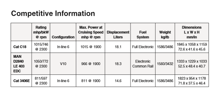

    That said, even with zero experience with the boats the OP is interested in, weight saving alone (more than 2k lbs) would make me lean towards the MANs. Whose more comparable Cat engine would be the 3406/C15 btw, not the C18.
    I also like the fact that the V8/800 are their very last mechanical engines, and it's no coincidence that they are what I've got in my boat.
    But some boaters like electronic throttles and digital displays better than simplicity and reliability - each to their own on that.

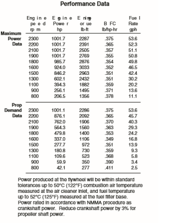

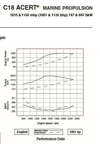

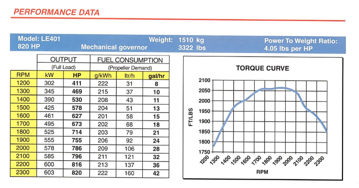

    The physical differences:
    CAT 1001 hp, use the Prop Demand Data to compare fuel consumption (gph).

    If you are looking at existing MAN installations:

    There are two different MAN Engine models being thrown about, a V-8 and an Inline 6, both had ratings in the 820 - 800hp range.
    The V-8 Versions started in the 43' and above, ranged from 800, 820 and finally 900.
    The Inline 6 was rated at 800hp and was more compact and a perfect fit for the models 40' and below:

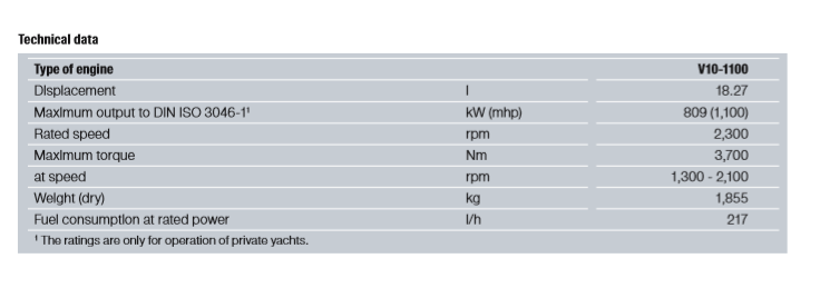

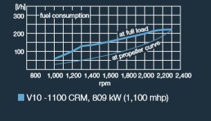

    @PacBlue: the table in your last post is taken from the brochure of the "D2840 LE401", which was their last V10 mechanical engine.
    Which has been available for a while together with the V10 "D2840 LE403", rated at 1050hp and equipped with an early (non-CR) electronic control.
    Afterwards also converted to CR, rated at 1100hp and labelled as "D2840 LE423", before they eventually phased out the V10 block altogether.

    Yeah, that MAN model designation caught me, 2848 is the V8, 2840 is the V10, and 2842 is the V12. No a very intuitive system, glad they changed it over.
    No 820hp V8 ever existed.
