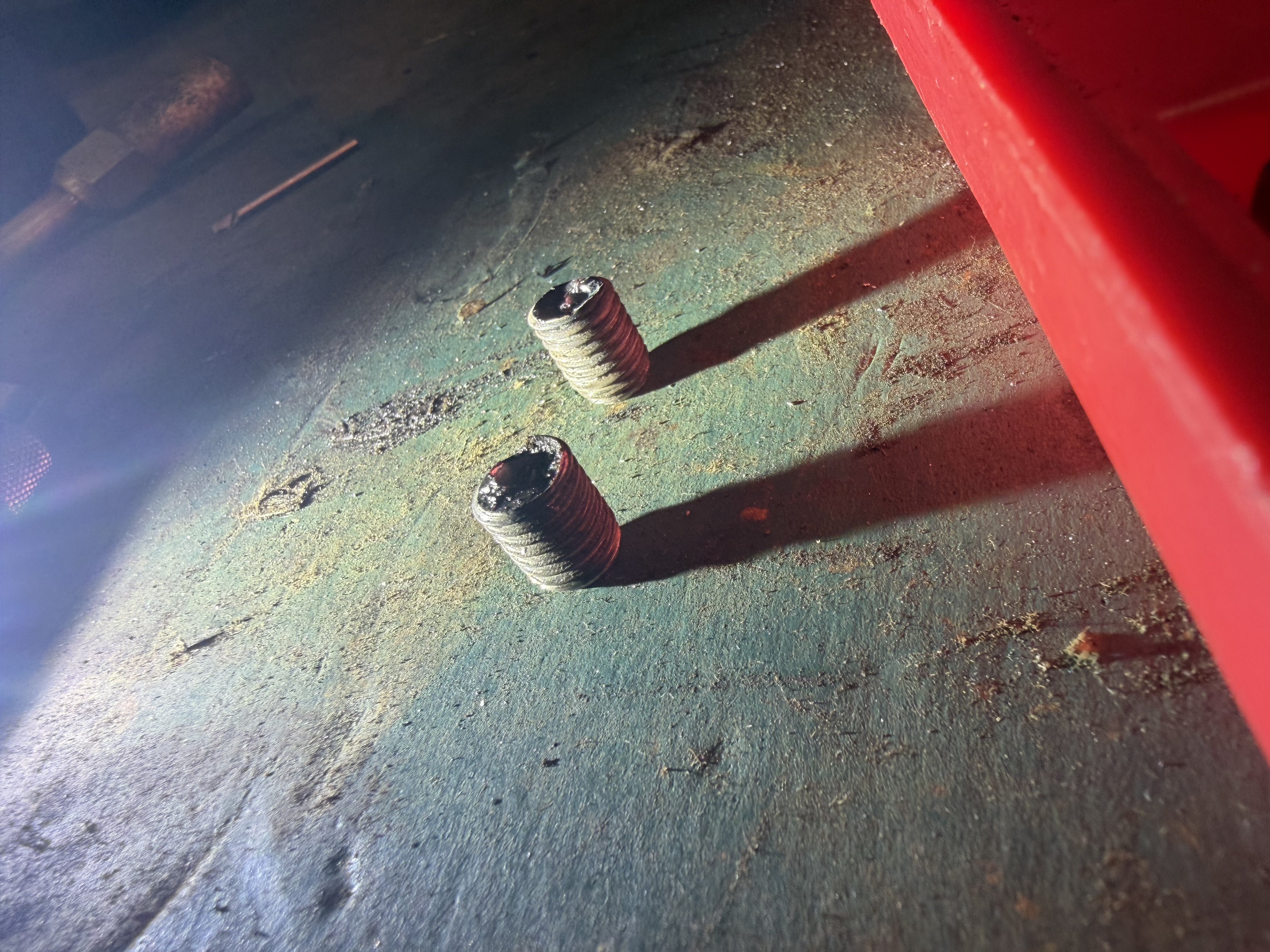

    Following up, two of the four turbo studs were indeed broken. The tech who drilled them out pointed out the same thing I noticed - the flange nuts installed instead of the proper nut/washer stack caused the problem. He had to heat and drill out the broken studs. The turbo clamp to elbow also broke and has to be replaced. Good lesson that simple details like the proper washers really matter. Sad that this messed up our keys trip after the same botched job also messed up our Bahamas trip. But we rented a place in the keys and trailered our 17 mako down instead so not a total loss.

    Washers, O rings and seals.
    Almost always, well, and shoddy wire termination…
    Thanks for sharing the follow up.
