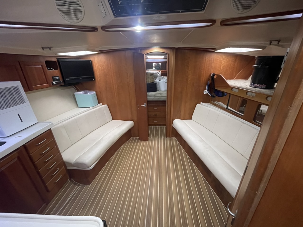

    CF853F71-69D0-4B80-85A9-D1E7638F389E.jpeg Just installed some new teak and holy ply down below... pretty happy with the results!

    Hey that looks good. Nice job. Are you going to apply a finish over it ? Varnish or poly of some sort ?

    Thanks! Yes a matte finish poly I think. Haven’t had the time to get around to it yet.
