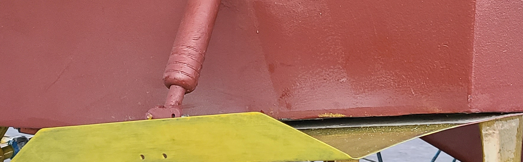

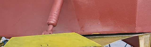

    I have a 1990 Ocean Yachts 48' MY with a rattle over 1500 rpm at the stern/rudder area which is also on the port side. My boat is currently hauled at Lamb's Yacht Center in Jacksonville FL. They were not able to track down the rattle and are guessing it is the trim tab. I don't believe that is the problem. The trim tab is just a thin sheet riveted to the hull with a hydraulic piston that moves it 3" max, and I don't use it on the port side because the boat lists to the port. My question if I remove that tab altogether (to eliminate that possible rattle source) and leave the starboard one how would that effect the boat running underway? The reason I am considering it is that I plan on installing the Zipwake system and I feel the current system is almost useless.
  2. Pascal
    8,163
    I ve never heard of a trim tab rattling... yours look a little unusual as I don’t see a hinge and it seem to be inserted in a gap in the hull. Or is it something with the picture.
    with the amount of pressure caused by water I don’t see how it can rattle. But I ve seen weirder things in boats
    does the noise change when you move the tab down ?
    only down side to removing it is that you won’t be able to adjust running angles.

    The tab in the picture is disconnected from the piston while it was painted and you can see it's at it's maximum travel position. It's attached to the hull with 14 Phillips head screws. I've never seen a setup like that before.
    Not sure if having only one will affect the water flow under the boat.

    Ocean did most of there boats tabs this way. Mine are the same . They make up there own tab out of stock 316 sheet metal and fab the size the need for each particular model. Then throw their hydraulic piston off the Stern lower transom pocket to the tab .
    It’s only 18 gauge sheet and they just screw it to the hole without a hinge it just flexes under pressure because it’s only a two or 3 inch travel.
    Yup don’t remove it and that is not causing your rattle whatsoever. Yes like the other said get them working.

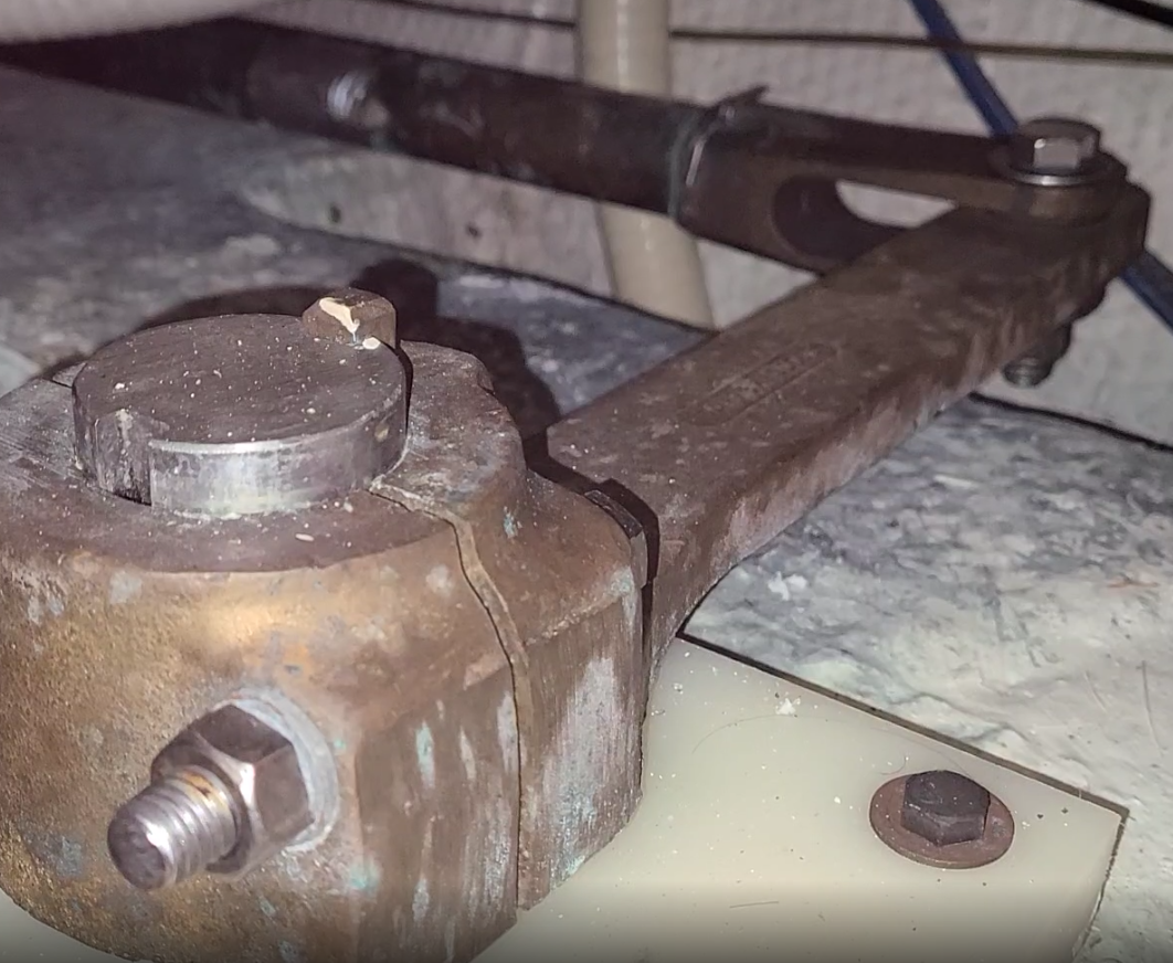

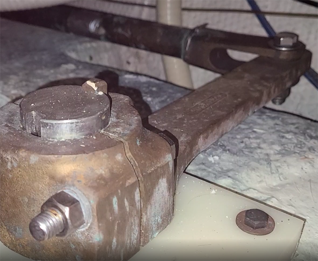

    I also do not believe the trim tab is rattling. I still think it's the connection between the rudder arm and connecting rod. There only seemed to be a bolt and no bushing, and it had a fair amount of play. Lambs doesn't seem to think it's an issue. It's a constant rattle over 1500 rpm.
    I did not feel any vibration when it rattles. The props were just changed and it still rattled. Two different yards and 2 different divers have not found anything wrong with the shafts or struts. But until the source is found I'm not eliminating anything.

    Possibly that key is worn. Possibly something isn't tight. Put someone on the helm in open waters and ride down below. Shouldn't be hard to zero in on a rattle, but there's a lot of places it could come from.

    Loose rudder connections would be a good place to check. The rudders are in the prop wash, with a lot of variable pressure.
