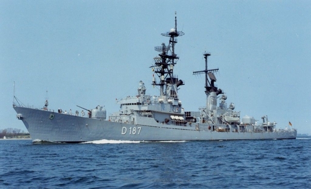

    Steam turbines
    One time in my life, I have been in an engine room with multiple running steam turbines. On a German Navy DDG Class Missile Destroyer during an combined air / navy exercise. I was detached to the ship as a liason officer for that exercise. One of the Chiefs was a friend of mine and at times without air activity, I spend part of my off duty time with him in the engine room.
    Ambivalent experience, I must say. Very powerfull, great power to weight ratio (if you do not count the boilers but they were not in the engine room), very reliable but awful for the personel working in that room. I know, the engine room of an destroyer can not be compared with one of those mighty liners like the old Queen Mary or the United States and working in the military is not a soccer game but it was awfully hot, noisy and everbody was always afraid of leaks in one of those numerous tubes and hoses. The high pressure, ultra hot steam was supposed to be invisible and could have cut a person in half when walking trough it. Warning signs "Be aware of steam" were all over the place. I can tell you, the young Lieutenant was a bit scared :eek:.
    But it was impressive to see this ship doing speeds above 30 Kts and evasive maneuvering like a PT boat during simulated air attacks. Very effective weapon system. But these American built ships had awful quarters for the normal sailors. Then I understood their saying "Join the Navy, see the worst" :D
    The times for steam turbines as prime movers for the merchant navy are over because of their low effiency. Ironically, their revival was caused by the demand for more energy efficiency in ship propulsion. Today they are used for waste heat recovery of hot exhaust gases on large 2-strokes and gas turbines. With all means of wast energy recovery on the latest large 2-strokes, the specific fuel consumption of those engines is down to 150 g / KW / h and the overall effiency above 50 %. On special transports, where the cargo has to be heated during transport, the TE can go up to 80 %.

    Can't imagine how dangerous that environment was for those servicemen. My marine engineer colleague tells stories of carrying a broom extended forward as they traversed the machinery spaces during commissioning on some steam powered ships, and had the rare event of seeing that broom head disintegrated by vaporized steam as he held it - a sober realization that could of been him except for the 4-5 feet of "broom security" .......
