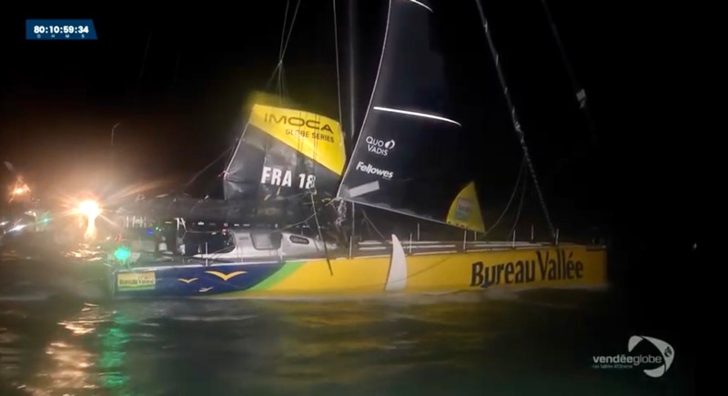

    I was watching the second Imoca crossing the line in the Vendee Globe last night and noticed his red and green running lights being located on the stern. This means they are almost invisible to another vessel right off the bow... especially in heavy seas
    There has been few shots of the mast in the broadcast but so far I haven’t seen any lights up there. This doesn’t make any sense and could explain why these guys are sometimes involved in collisions like Boris Herrmann last night just 90 miles from the finish.
    I know lights are regulated in the COLREGs but can’t help wondering if this a European thing

    Not uncommon, but when the lights are on the mast the lights are well above eye level. I think the placement of the lights in the pic is so another boat will know where his stern is if he crosses their bow to cut off their wind. Not like they give each other a wide birth.

    These Imocas have outriggers amidship to hold the stays, that would be a great spot for running lights. Even though they don’t taper much at the stern, that’s not the widest point

    If you'll notice the lights aren't on the hull, but instead raised above the level of the deck so the light can be seen forward and the arc is complete.

    The stern of these boats is pretty low so in heavy seas they would be hard to spot especially with the outriggers and foils getting in the way.
