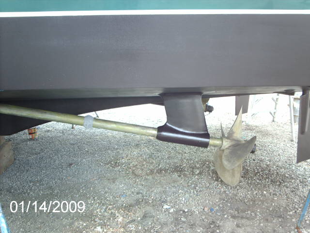

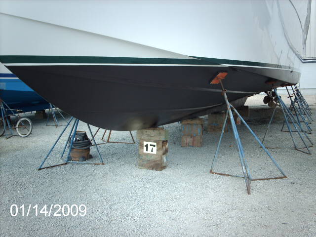

  17. Bamboo
    Bamboo Senior Member
    Dec 19, 2008
    934
    Palm Beach, FL
    Goes on the bottom tomorrow, Tuesday I may get out the inlet and do a sea trial. No additional prop speed as I thought did not really need it, and at over $600 for my shafts and props I left them alone. After one year's use they were quite clean, and they appeared to be coated enough to leave it alone.
  18. Bamboo
    Dec 19, 2008
    934
    Palm Beach, FL
    Here's a few pics- goes back in the water shortly. :) Props static balanced and so no real need for high speed balance, plus that meant stripping the prop speed off which is one year old and still looked good. Previous high speed balance did not need to be redone is my thought. Report to follow sometime next week.
    I think these pics are the right size and not too big.
      65.7 KB
      1,197
      64.4 KB
      1,204
