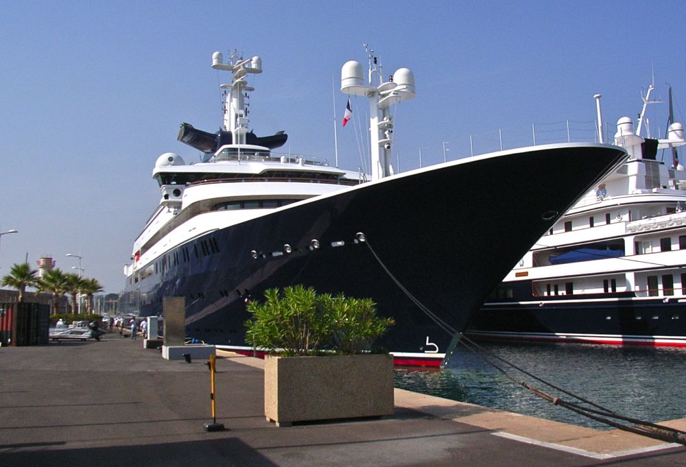

  11. AMG
    5,378
    Octopus is a big boat, here in Antibes in 2005...
