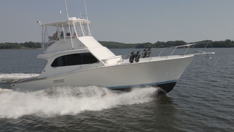

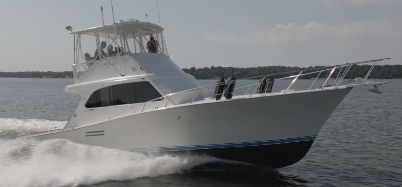

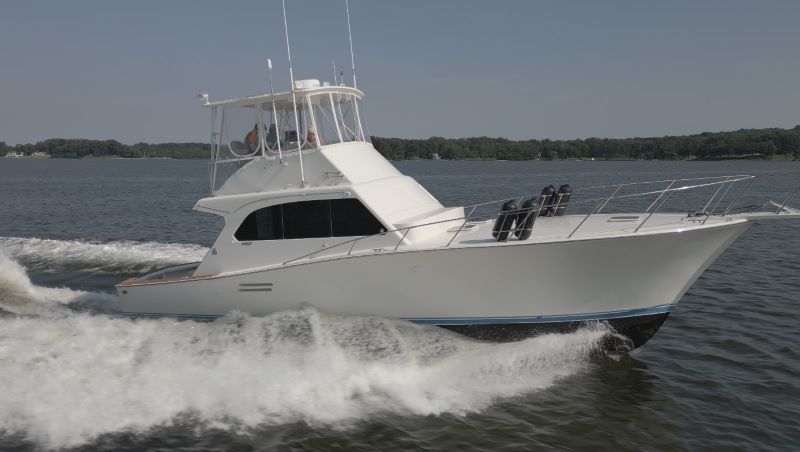

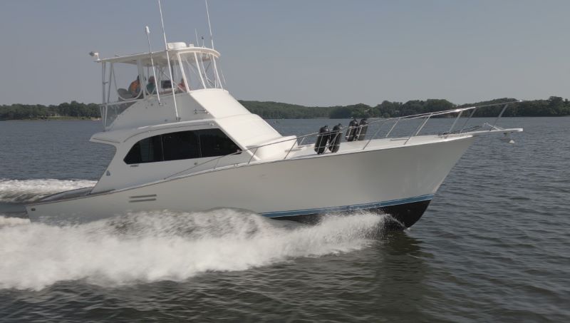

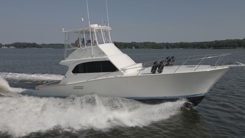

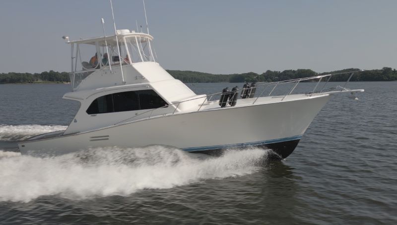

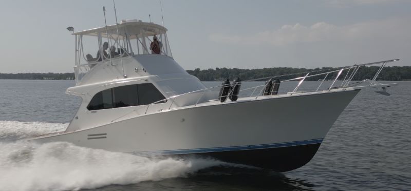

    Was able to get some aerial video with a friend. Video is on a very flat day in the river so I could see running attitude without wave interactions. Still shots are cruise tabs full up at 20 kts, 22 kts and 24 kts. Open to comments. I think a little tab at 24kts (and above) is good. I did play with adding a little on recent trip before I had the video and a little tab brought 24 kts to 25 kts. That run was also on a pretty flat day.

    Curious why you are opposed to running with tabs down? Sounds like the stern lift from tabs down gains you speed and therefore efficiency?

    I'm not opposed to running tabs down per say. Before we removed the (original owner added) bow 'spray rails' I felt that the bow wouldn't trim up enough, expecially in following wind/seas. Now that the add-ons are gone I wanted to see how the running attitude compares to other Posts (the new 42 is basically the same hull and have photos of it from the brochure). It also seemed like the Post ran with the bow lower than our prior 35 Viking, but some of that could be the optical effect of the shorter foredeck of the Viking.
    The first time I saw a performance increase trimming the bow down a bit at higher speeds was a couple weeks ago with the old rails removed. Removing the rails also did what I hoped and greatly reduced the roll when crossing steep waves/wakes.
