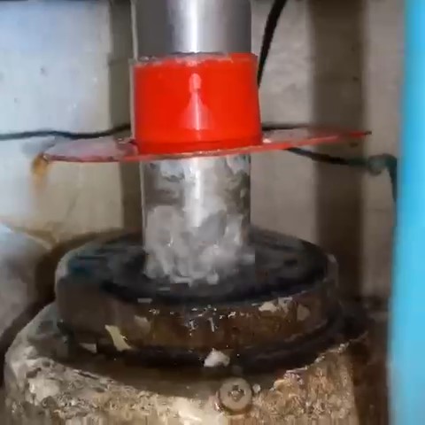

    Does anyone recognize this type of rudder shaft seal on a 1998 Post

    that is tides marine the red piece you are looking at is to help with the install of the new seal that model is called STRONG SEAL you can get the replacement seals from tides marine in Fla

    Excellent, Thank you. Can they be changed while the vessel is in the water?

    i wouldn't do it once you remove the rudder arm from the shaft to remove the seal you have to remove a spiral clip that holds the seal in then the seal water will be coming in

    I think that red seal guide is facing the wrong way.
    Also, the post looks like corrosion or barnacle fouling??
    Did somebody push the rudder up?

    You know Capt, I thought of that. I had the boat backed in for the 2000 hour MAN overhaul at a facility with skinny water as you got closer to the bulkhead. I actually tied up about 15-20' off the bulkhead. Another factor - both shaft are leaking. That red, whatever it is, was down on the seal, I pulled it up.

    Also, that's bubbling water at the seal and shaft joint. It's just in poor focus

    That red thingie may be a way to keep junk off of the seam from the inside.
    It is a pressed in seal like the ole Strong seal system. I'm not a big fan.
