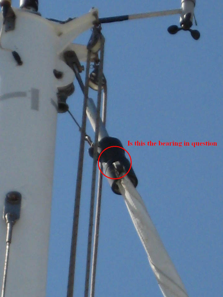

    I own a '67 Yorktown 39.4 sloop, I have a roller furl reefing system on the forward jib. it is the kind of furl that rolls the jib around the stay, without the stay twisting itself. (there is a sheath on the stay). the bearing near the masthead is seized, I think.
    anyone ever have this problem and fix it WITHOUT taking the stay off?
    it is an option, I have a secondary forward stay the connects mid deck, for the secondary jib. But i would rather NOT spend a day with my boat taken apart.
    if not, any easy ways to take down the stay and furl? I am a rope rigger, but not a very experienced sailor. I am planning on tensioning the secondary forward stay, and then loosening the main forward stay, pull pin on bow, and then climb mast and slowly lower the stay/furl to the dock.

    It has been several years since I messed with this stuff it sounds like you have a couple off issues going on. First of all the slider that is attached between the halyard and the head of the sail usually have delron or similar ball bearings in them and it is not uncommon to get a salt buildup which can sieze them up if this is the case oil will do nothing you need to flush it with fresh water

    The other issue is that it seems you have a broken halyard that is tangled up inside the mast which is causing some problems, I would suggest that you need to deal with this ASAP. I think I would be pulling all the halyards to check their condition, run a mouse so you can re thread them.

    today, I scaled the mast again, this time armed with a few big wrenches.
    I put them both on the halyard furl pulley. and CRANKED.
    after about 5 min of straining, I turned it. then drenched it with penetrating oil.
    the Furl now works perfectly. we plan on de-rigging it for a bearing replacement as soon as we get our ship home.

    that was it, yep. but we got it fixed. thanks!!!

    In the picture you posted, the angle between the halyard and the stay, is dangerously small. I'd put a short strop either at the bottom or top of the jib, so the halyard is better able to resist twisting.
    It's my feeling that you probably know about this, but i think this angle may also be related to Calvin's problem.

    I do agree about the angle, I took a photo of a boat docked next to me for an example.
