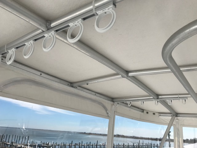

    Half my salon couch had a storage space filled with the extra bed cushion/platform that I never used. Just took that out and store most my rods in there. I also velcro strap a few up in the framing for the fly bridge top. Probably not what you were looking for but its how I solved my problem. I also don't have to worry about salt spray damage on Lake Ontario.

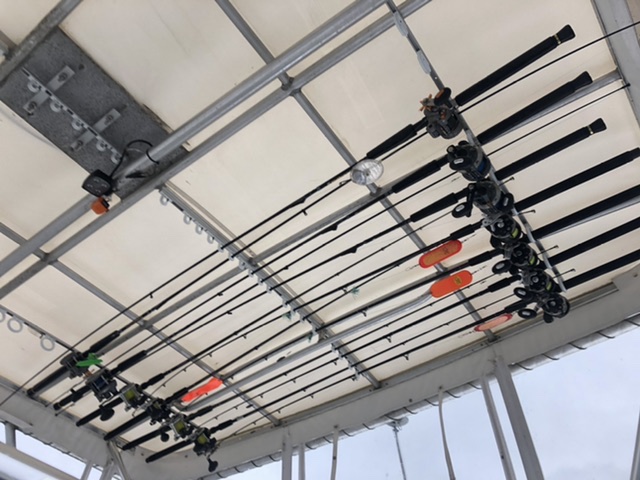

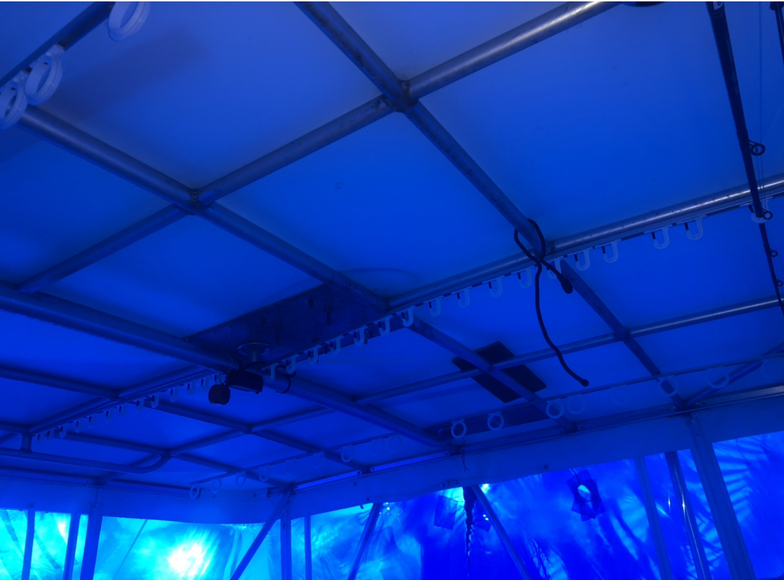

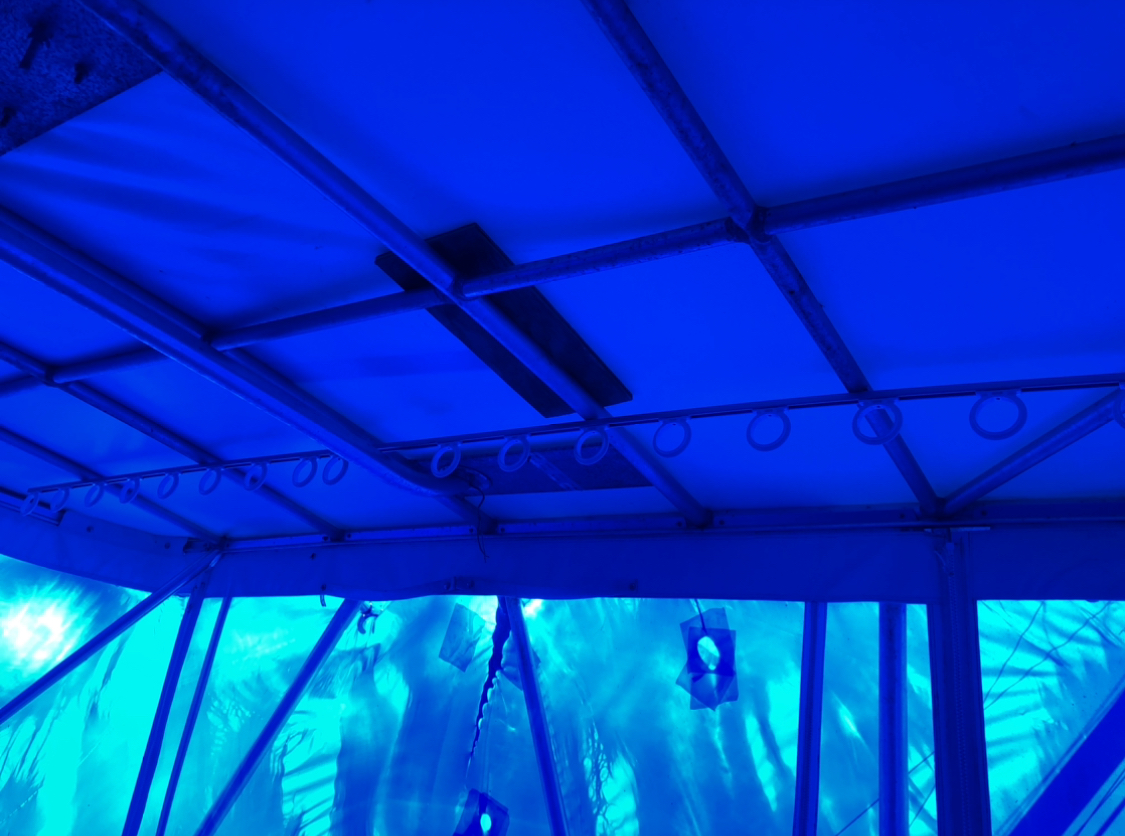

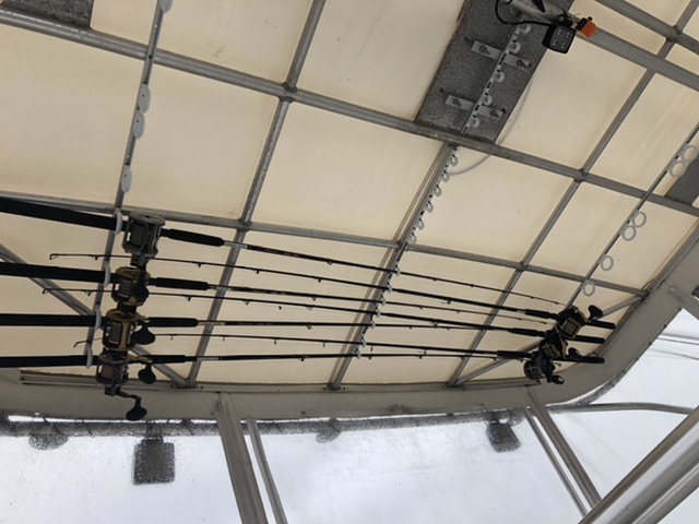

    Funny you started this! Today I began working on the same. My wife does not want the rods in the cabin on this boat. I am going to try hanging them in the flybridge. I am using Du Bro tracks and holders. I’m drilling/tapping the aluminum framing and going to use Loctite. I’m concerned with the weight and the annoyance of the rods swaying with rocking. We will see! Sorry for the blue, boat is still wrapped up
  4. Capt J
    14,432
    DO NOT use locktite on the s/s screws going into aluminum. Use Tef Gel to keep them from welding themselves together. You still will not have an issue with any of them loosening on their own.

    Ad an extra drop where the new rail contacts the top tube. Further sealing the screw and keeping the contact area free of moisture. Even though its alloy to alloy, some surface white can still appear.

    I went with the rod holders on the ceiling if the bridge, but I like how you have the reels alternating, i’m going to change it

    Still a work in progress and making some tweaks. In a couple weeks I will be able to get better non blue pics! Hard to tell but the rods are going port to starboard.

    Holy cow, that is a lot of rods. I need to go buy a few more:D

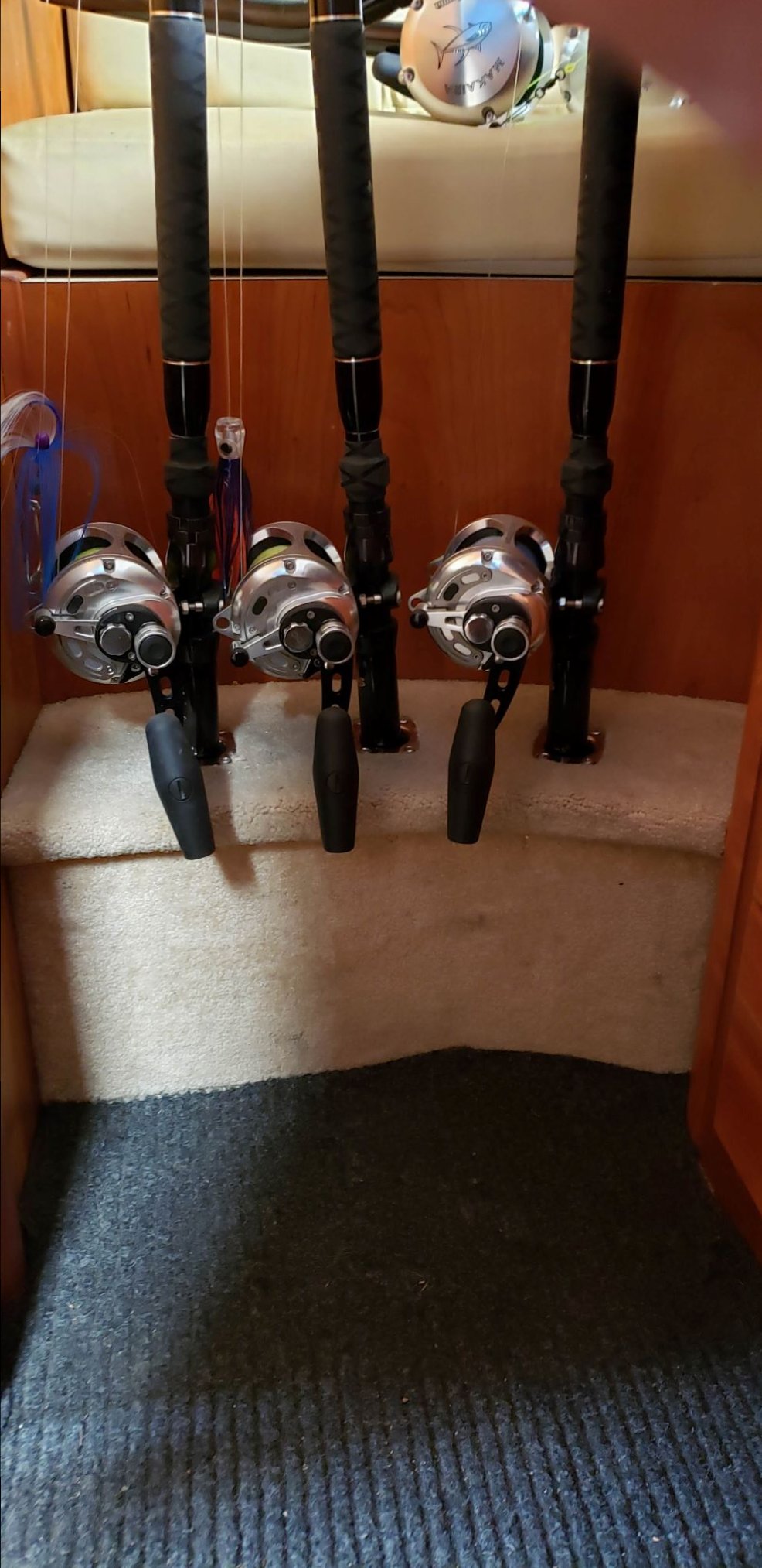

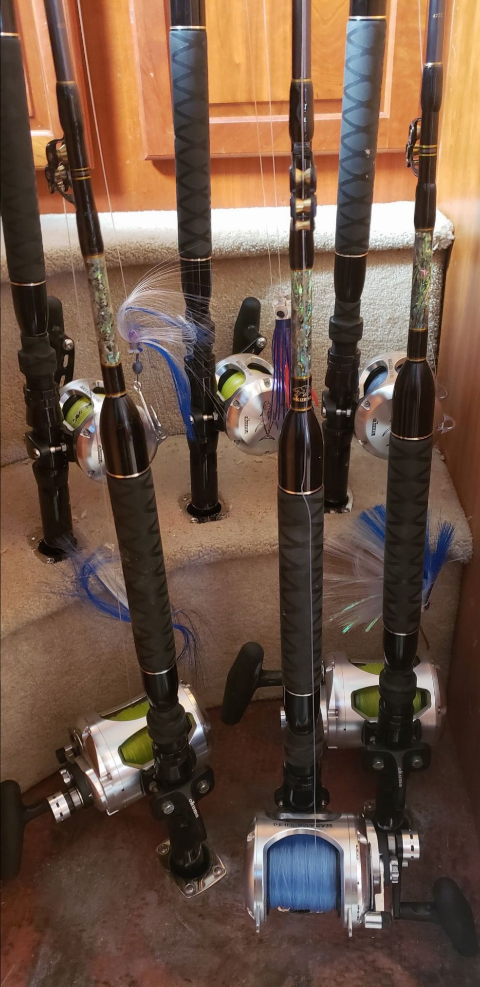

    I finally got the chance to work on my rod storage problem, I think it turned out great. There is plenty of room in the steps for rod holders. There is room on the starboard side in the floor but the port side has the large tube/chase for wiring directly under the floor.
    My bent butts still need a place, may just be easier to get a couple of the winthrop adjustable butts.

    I like it!

    Started getting a couple of the rods stored!
