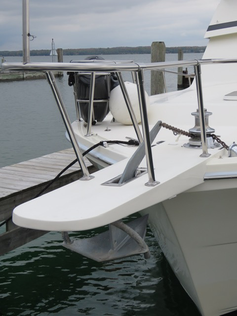

    Just wondering what you found out or decided. Looked at an old brochure for my boat that had a Danforth on the bow. Pictures look about like the way my Rocna rides

    My danforth rides like your rocna, I want to find something that sits better

    If it's not too late to reply to this discussion I'd like to know if you went with Vulcan and how it's working out. I bought a 1988 44 Viking motoryacht in November that came with BBB chain and a very undersized danforth considering it's a 40,000 lb boat with considerable windage. I anchor out overnight often and my preference would be a 73 lb Rocna or a 55 lb Delta. The problem is that the anchor roller slot is too tight to allow most suitably sized anchors. I decided to go with a 55lb Vulcan and 5/16" G4 chain. The BBB gypsy on my Ideal windlass handles the G4 fine. The links are the same size as BBB. After trying the 55 lb Delta I decided it was just a a little too big for the roller slot. It didn't nest well on the pulpit using just the windlass. It needed to be hoisted up a little higher into the slot by hand. No big deal since I need to go forward to secure it anyway, but the size was still a little awkward and the pulpit bounced a little more than I'm comfortable with when when lowering anchor, at least until the anchor hit bottom and the bouncing would smooth out while paying out just the weight of the chain. Before someone asks, the pulpit is solid and core is good (core in pulpit and foredeck was replaced). It's just a heavy chain and anchor for a long pulpit with lots of leverage. I ended up returning the 55 lb Vulcan and ordered a 44 lb vulcan. the 44 is undersized for the boat according to the Rocna/Vulcan Chart but still way better that the danforth and at least equivalent to a 45 lb Delta (the size Delta recommends for the boat). I'm wonder if maybe a spade would fit in the slot better since the shank appears to be proportionally thinner than similarly sized rocnas and vulcans. It's still a mystery to me why a quality boat builder like Viking would not include a bow pulpit design that allows for an adequate sized/design anchor. No way I'd sleep well swinging on a danforth overnight. I have zero confidence in a danforth resetting when spinning with the tide. At least in Chesapeake bay bottoms.

    I tried to upload some photos of the 55lb Vulcan seated in my pulpit before I decided to swap it for the 44, but I got an error message saying the photo files are too big. I’m new to this forum. Is there a trick to uploading a standard photo taken with a phone?

    Thanks for posting the photo. Now you have me considering a Rocna instead of a Vulcan. I had just assumed a Rocna would work due to the roll bar and the shank geometry. Does your windlass pull your Rocna fully into the position shown in the photo or do you need to seat it on the roller by hand? Also,do you have issues with the anchor sometime coming up in the wrong position and jamming in the slot? I had both problems with the 55 lb Vulcan I returned. My 44 lb Vulcan is waiting for me at west marine. Not looking forward to playing with chain and anchors on my bow in 20 degree windy weather, but no other option if I want my ground tackle sorted out by spring.

    Would u be able to email me the photo so I can see what it looks like?

    Sure. I’ll try sending it through a conversation. If that doesn’t work I’d need your email address.
