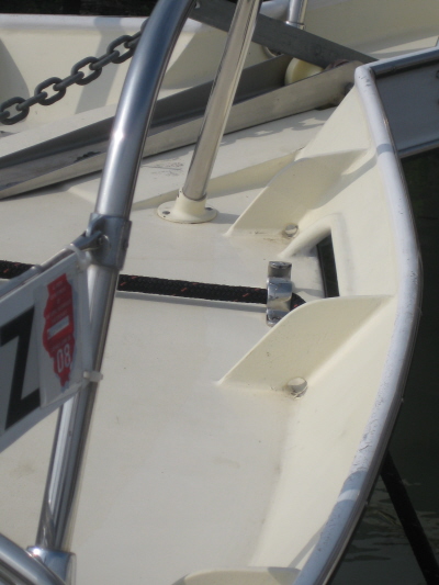

  4. Due to the sticky gray sheist that kept oozing out for 40 years, I elected to remove mine altogether and fabricate bulwarks above the deck line. Since my aluminum is almost 1/4" thick
    (.220) I find that drilling and tapping is almost as bullet proof as through bolting, plus I bed all that stuff with 5200. ws

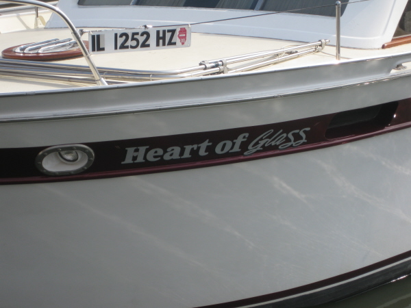

  6. Thanks Joe... thats what happens when you own the same boat for 38 years! Always have projects that pop up, like the wood windshield/roof support frames that are second generation and going this winter. I'd like to do the pilothouse sides and front with aluminum plate and install nice new windows mounted in rubber. I am getting too darn old for too much more of this kids' stuff! ws
    [​IMG]
    [​IMG]
    notice the rot in the lower right corner...
