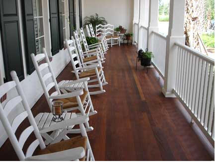

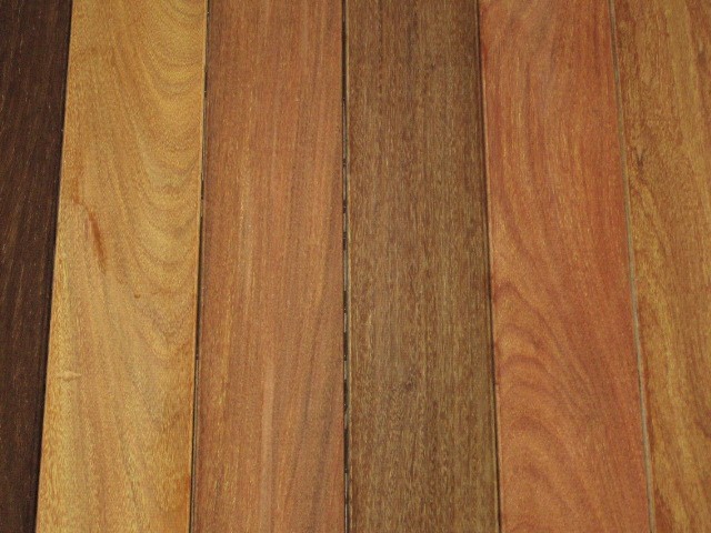

    One word; Ipa. http://www.ipe-wood.com/faq.html#other
    If you have a table saw you can rip down the 3/4 x 5 1/2 inch boards into strips.
    It's heaver than teak and won't hold a stain or varnish very well because it's so hard. I have gone on about this wood before so I'll keep it short.
    It's very cheap, about $1.80 a lin. ft. for a 1x6 .I have worked with it on and off for years now. If you have any questions you can email me.
    Teak doesn't need diamond blades! It's not any worse then any other hardwood. Diamond blades are for concrete.

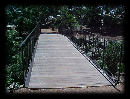

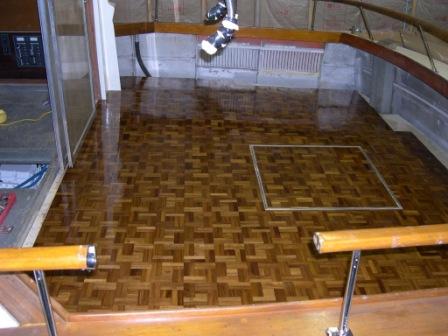

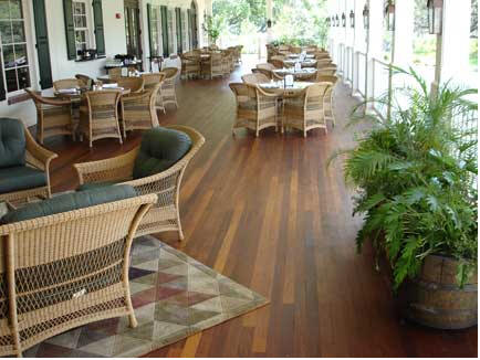

    Couldn't find many good photos there but found some more here:
    http://www.ipedepot.com/deckpicks.htm
    Interestingly, Ipe is a type of Brazilian Walnut. The price comparison with teak is great: $7 vs $15 per unit.:p and kept sealed will retain its original reddish-brown color - not always easy to do: http://ths.gardenweb.com/forums/load/porch/msg1015172230306.html
    http://www.woodweb.com/knowledge_base/Finishing_Ipe_Outdoors.html.
    Otherwise, it will turn silver (see last photo).
    More detailed comparisons here (Ipe/Tabebuia Spp. “Brazilian Walnut” VS.Cumaru/Dipterix Odorata "Brazilian Teak" VS.Teak/Tectona Grandis "True Teak"):

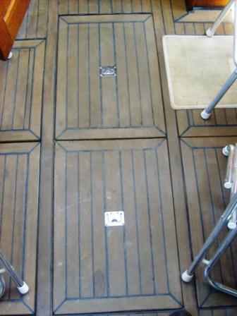

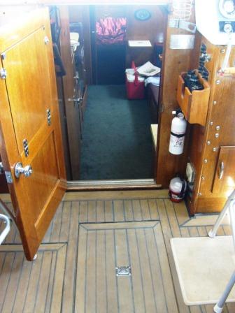

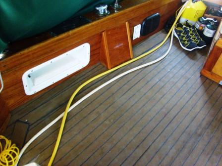

    Finally.

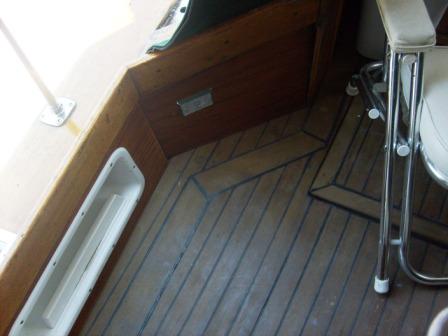

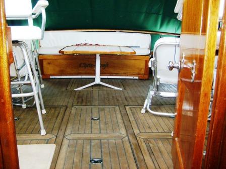

    For anyone who cares - photoEz of what Tek Dek actually looks like outback!:p

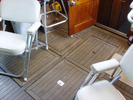

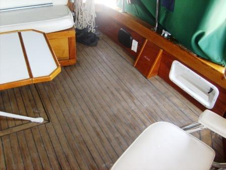

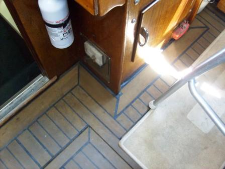

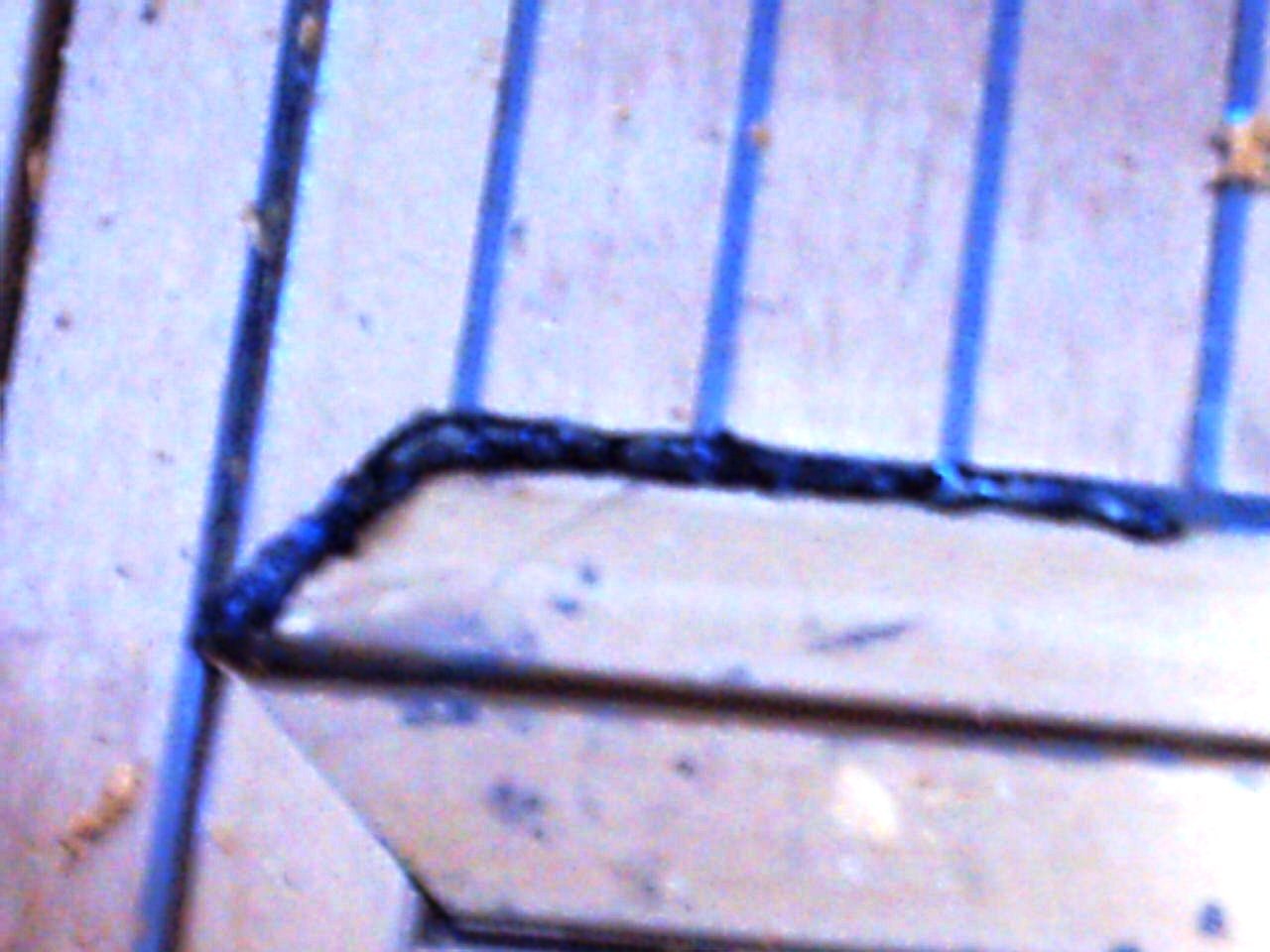

  9. alloyed2sea
    alloyed2sea Moderator
    Jan 28, 2004
    872
    Alex, VA
    Tek Dekky
    Three more for the road. :rolleyes:

    Tin Tonic really does have Tek Dek after all!!
    :D
    Finally some pictures of the finished product!! Looks really nice, more authentic than I would have believed. Looks like the installer knew what he was doing contrary to what the owner said earlier!!
    Thanks for sharing the photos Eric,

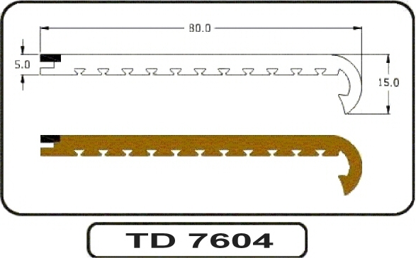

    That and the method of construction/application: tongue in groove; plus the nature of the dovetailed channels underneath which, when filled with adhesive, really "hold" the deck down.
    Amazing stuff really.

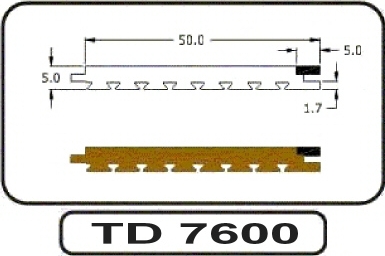

    PS - They even have TEK-DEK "LITE" now (see last photo):
    http://www.tek-dek-international.com/Tek-Dek Overview.htm

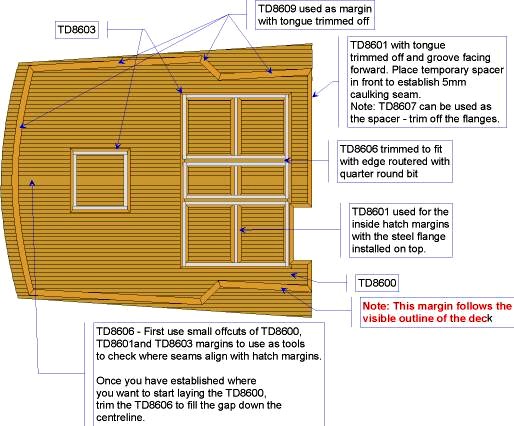

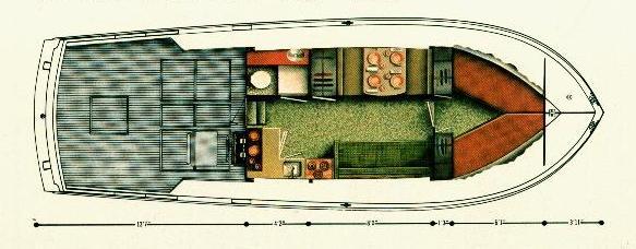

    Yes indeedee - sent them a factory blueprint of the floorplan -- and they provided a CAD/CAM schematic of an idealized laydown (including Kingplank) which proved invaluable. Will post this here once I get back to work.
    They really worked to make it happen.:p

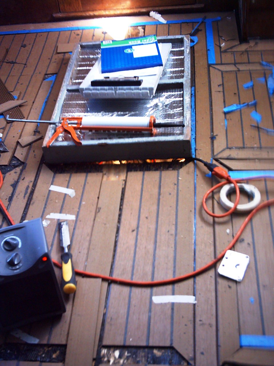

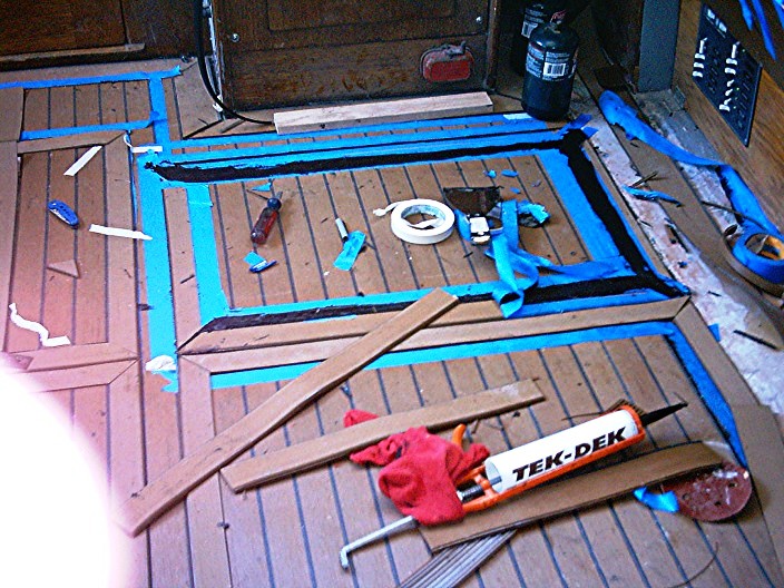

  15. alloyed2sea
    Jan 28, 2004
    872
    Alex, VA
    Combat PhotoEz

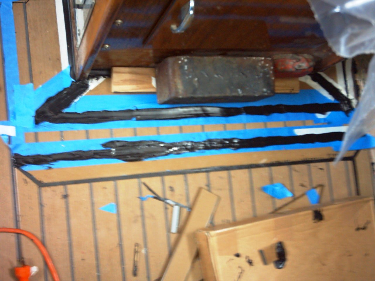

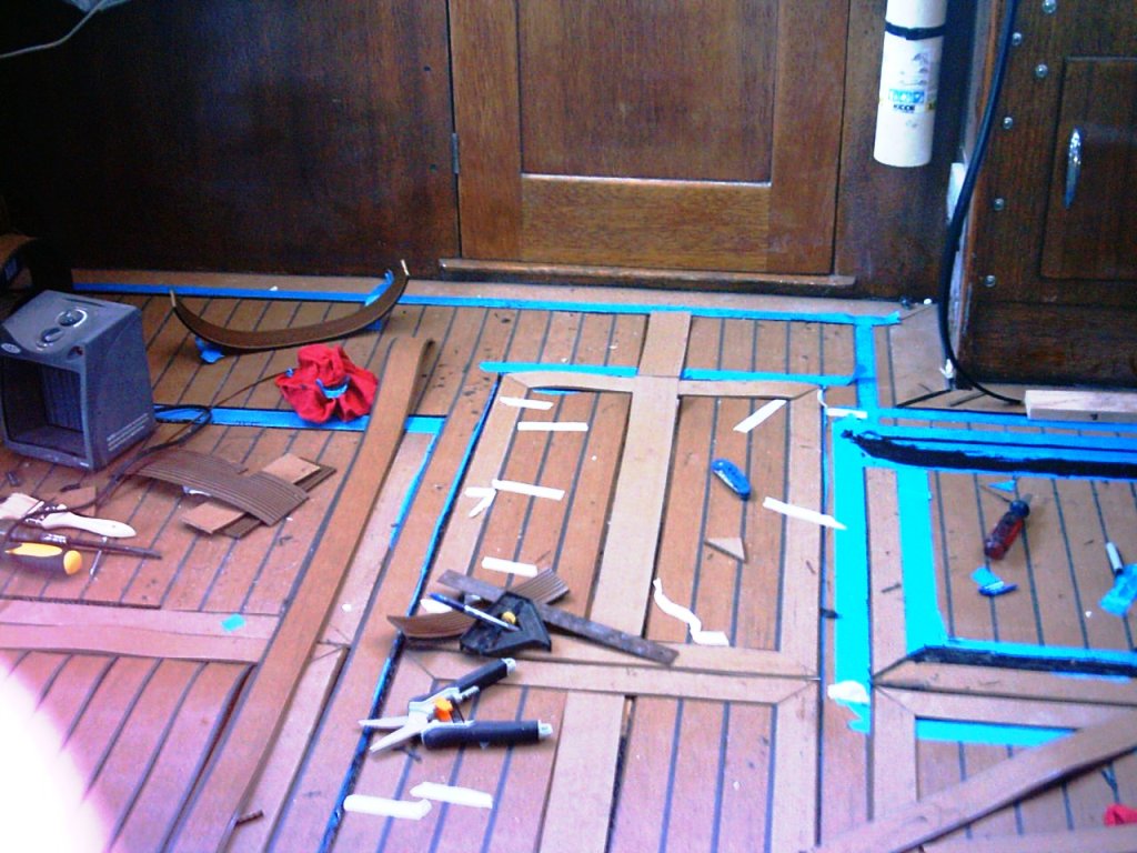

    For the war wary - how we actually "made sausage" -- redoing the back deck with TEK-DEK.
    Cheers!
    Eric
    PS - No live teak trees were hurt during the filming of this enterprise. :rolleyes:
  16. Capn.Morty
    Capn.Morty New Member
    Aug 14, 2007
    14
    Grand Haven, MI (Great Lakes)
    Looks Like work....
    You're starting to intimidate me Redman... I assumed this would be like installing floating wood floors in a house (except with curves and strange angles). This looks like more then a 6-beer job to me!:eek:

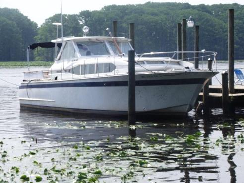

    New 37 Riviera aluminum
    I have not even seen my boat in person yet. Previous owner’s picture attached. With no choice under the selling charity’s schedule, I had to offer sight unseen, with no survey. ["Strike while the bug is close"] The 427s have not been started for about a year; will have to pump out old gas; need to transport, will need to add marine air. But bones appear decent and pretty good.
    As to the motors, currently 700 hours on one, about 800 on the other. Less than one 24 hr day use per year for over 40 years. Mallory electronic ignition on both motors. 4 cyl generator, reported as working. Refrigerator, working. December 20, 1966 (Shipping date). RXP-37-2508. Michigan boat until 8 years ago, salt and brackish water in VA since. In the water now. Previous owner has brochures, Mariner's Museum information, spare set of props, Seller kept a functioning dehumidifier and basic heat in boat during period of nonuse. Astounding. Barely broken in.. Hah!
    Am bringing to TN, then back home to TX when retirement gets here.
