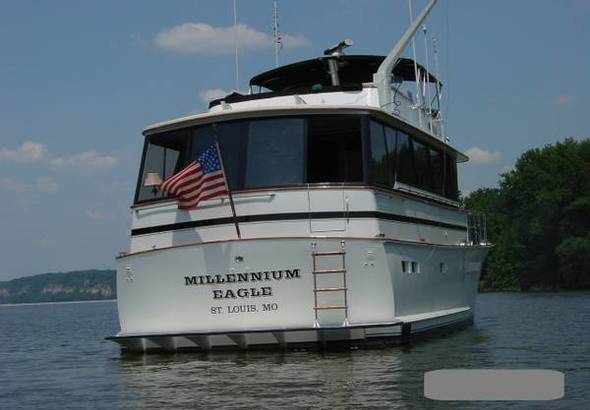

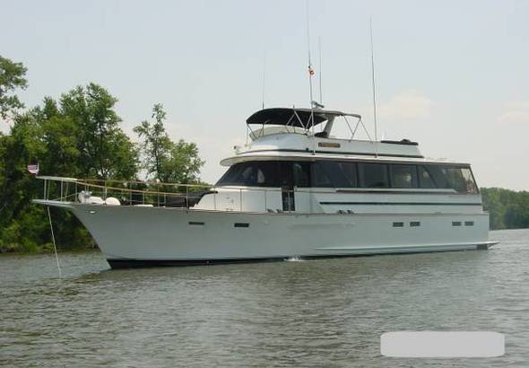

    Any moreover, somebody needs to explain what exactly which Roamer "Millenium Eagle" is: a 60' Houseboat? Or as the owner claimed, "Only 2 of these custom boats (62') were built in 1978 and were among the very last Roamers built by Chris Craft."
    She had T/12V71s; long FB; black trim; houseboat style; 11' Whaler; pulpit; "disappearing TV".
