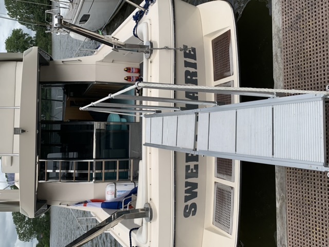

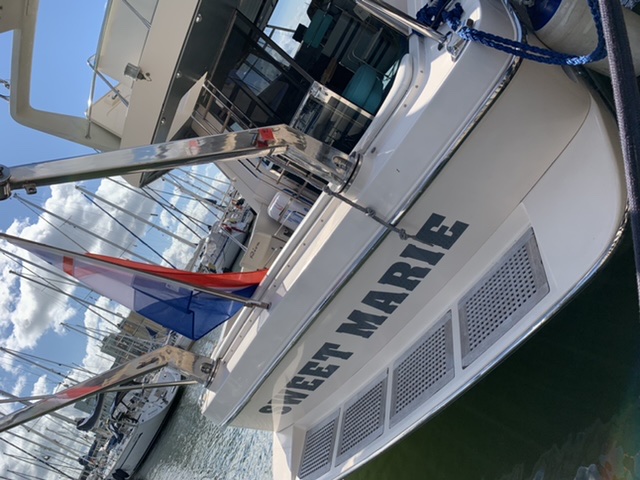

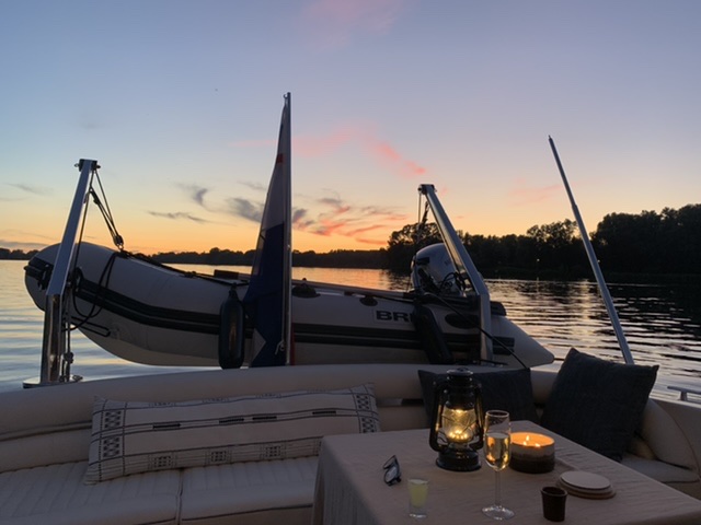

    If you have the Dinghy in the davids it will block either the name or the view a bit, we usually have it all the way up for docking reasons but it has never felt as a burden.
    Our boat has the original gangway that is fixed in the flagpole hole and davids, that is not very convenient if you have use for it on regular base, but in the Northern Europe waters gangway’s are usually used as diving planks by the kids rather than for entering the boat. I guess if you fix one this will limit the possibility for hanging the dinghy, but maybe someone else can advise better.

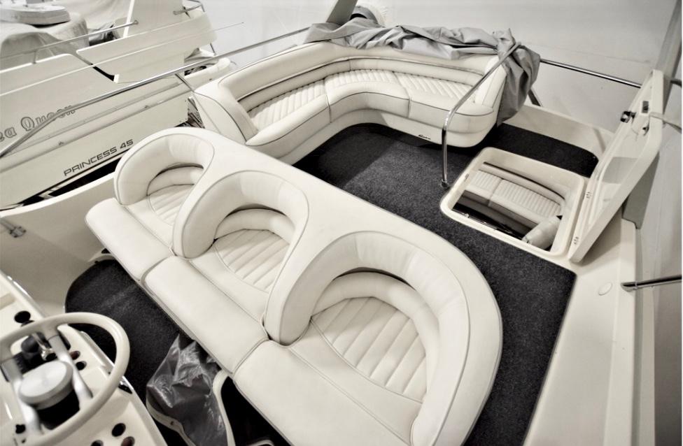

    Where did you order the couch in the stern from. It looks gorgeous and did you redo or recover the stern teak deck?
  15. HJ M
    HJ M New Member
    Aug 13, 2019
    6
    Netherlands

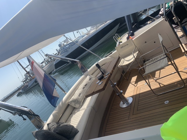

    The couch was done by a specialist in Finland by the previous owner (along with a matching lounge couch and drivers seats on the flybridge. The couch in the cockpit is a real plus, it seats 6 to 8 with ease and looks great.
    The teak deck was done last winter by our home yard (the same yard that did the complete restauraties of the Superamerica 50 that is currently for sale at Arie de Boom yachting in Port de la Rague). This Coral was not equipped with teak deck, but this realy compliments the cockpit so it was worth every penny ;-)

    Please send me pics of flybridge seating. Do you have a Sunpad on bow?
  17. HJ M
    HJ M New Member
    Aug 13, 2019
    6
    Netherlands

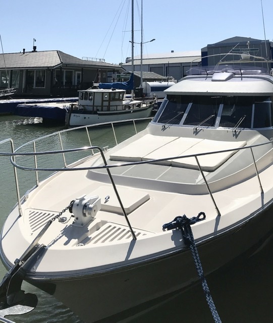

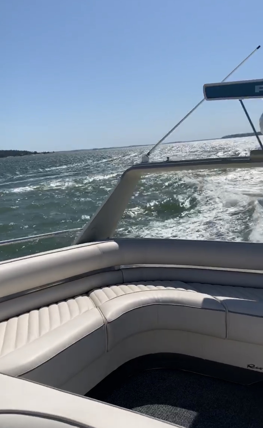

    The sunpad on the bow is still the original one. It concists of 3 pieces that fix together wit a velcro strip in between and press buttons on deck. I don’t have very well documented pictures of the flying bridge but these pictures should give you an idea..
