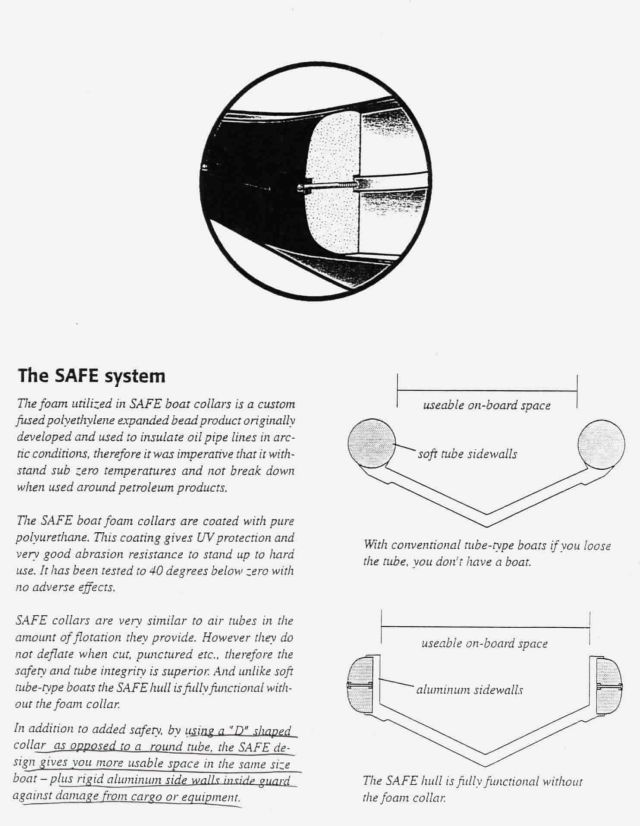

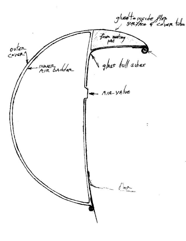

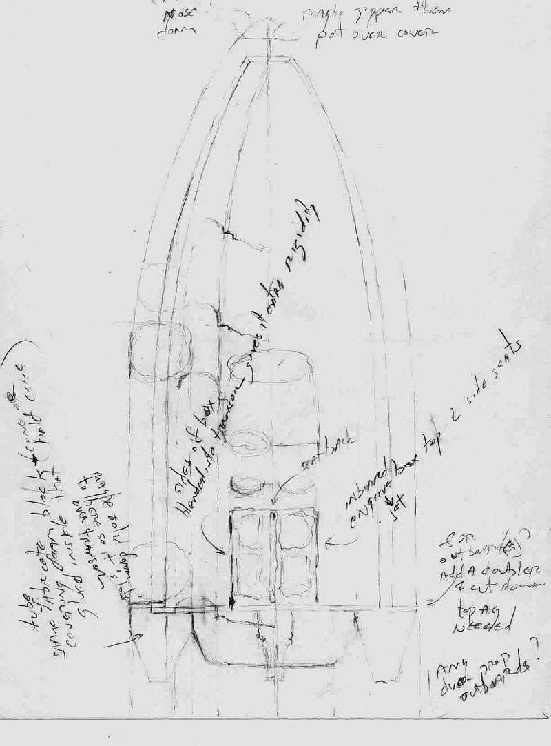

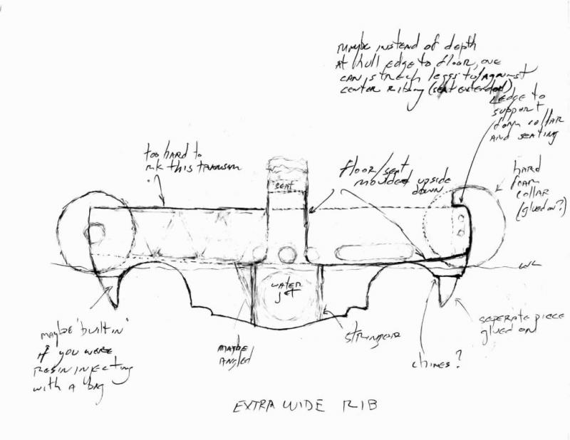

    foam collared RIB
    I don't know why someone doesn't come out with some small tenders making use of a foam collar (D-shaped) in lieu of the inflatable tube collars. In general the full rounded inflatable tubes really cut down on the interior space available in a small tender. And the 'inflatable' aspect adds to the complication/expense of these vessels.
    Here is an idea I put forward a number of years ago. Granted it is a little complicated itself, but could be simplified.
