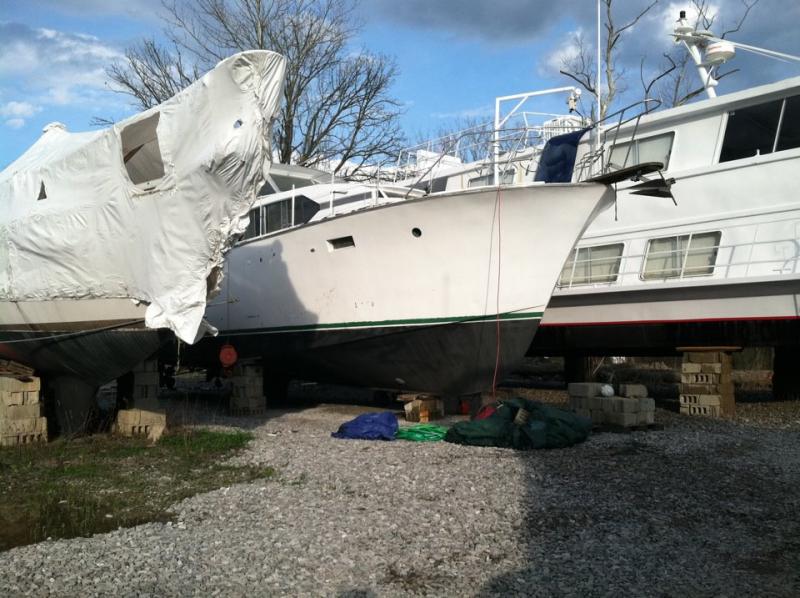

    I have been run out of the inside by the girlfriend and grandparents so I'm gonna start working on the outside god knows it needs it. this is the plan I have come up with so far .....
    1, Start at the top with a pressure washer 2700 psi and work my way down.
    2, Give her a great bath with dawn and other soaps ..
    3, remove all railings and remove old tow rail
    4, figure out how I want to take on the paint job.
    this is all gonna happen in 2 days ....wanna take bets ? ? ? lol I will post pics.
    Also I will need help figuring out what bottom paint I need I think it has coal tar on it now and it will need at least 1 more coat and then paint i guess ? ?

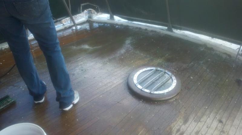

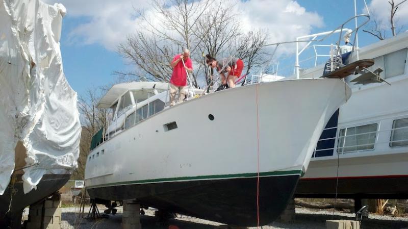

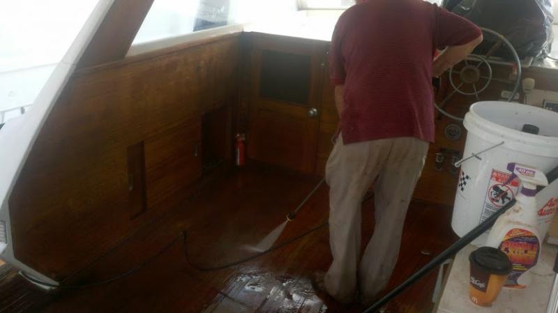

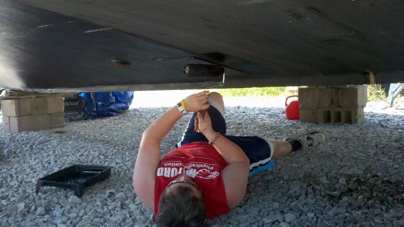

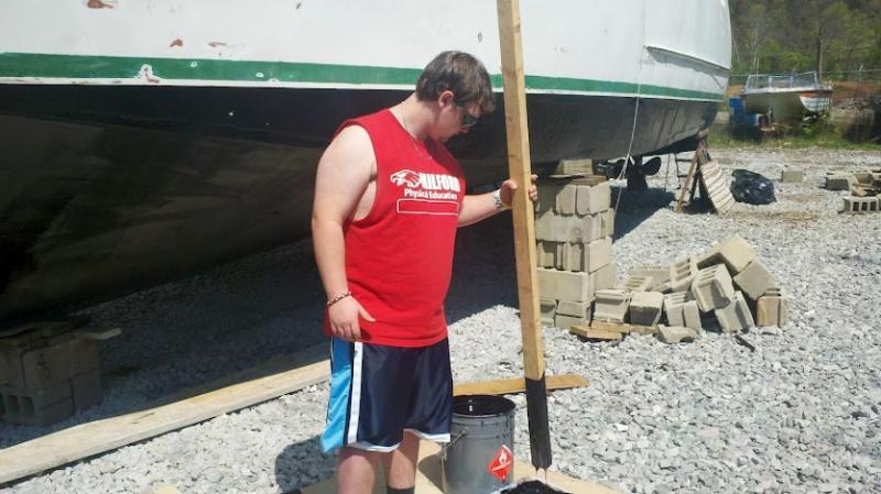

    yea I got too busy and forgot to snap a lot of photos but here are a few of my 88 yo grandfather working his butt off ..lol
  13. gibson36
    gibson36 Member
    Oct 9, 2005
    123
    Cincinnati, Ohio
    and a few more ..

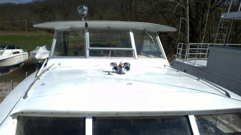

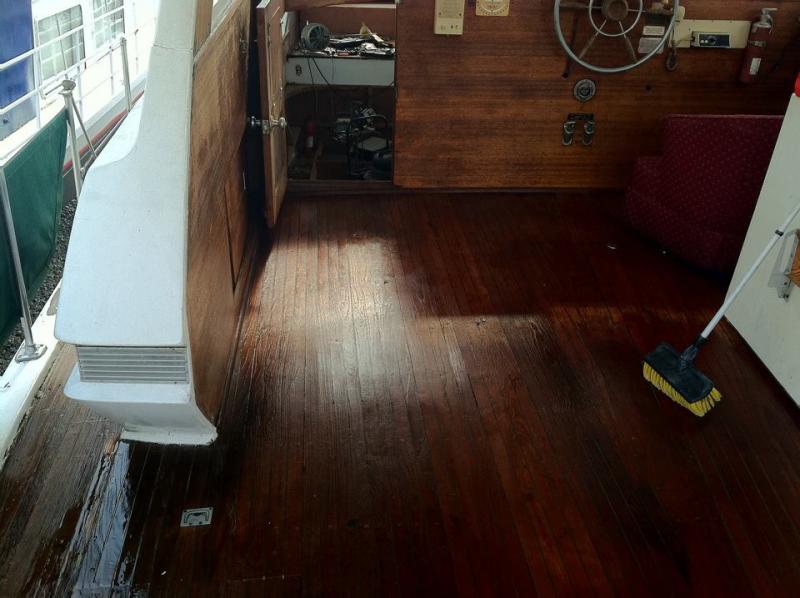

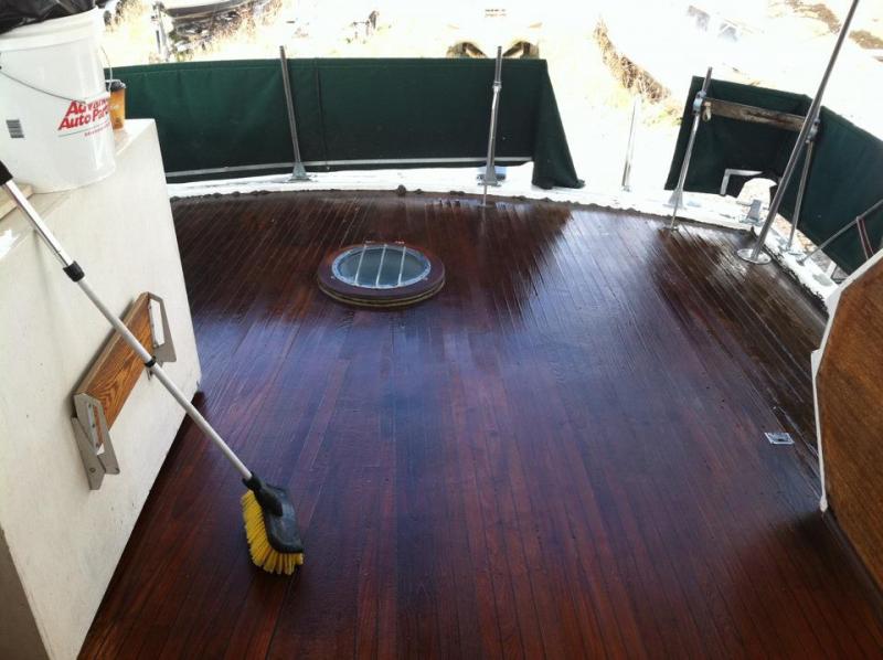

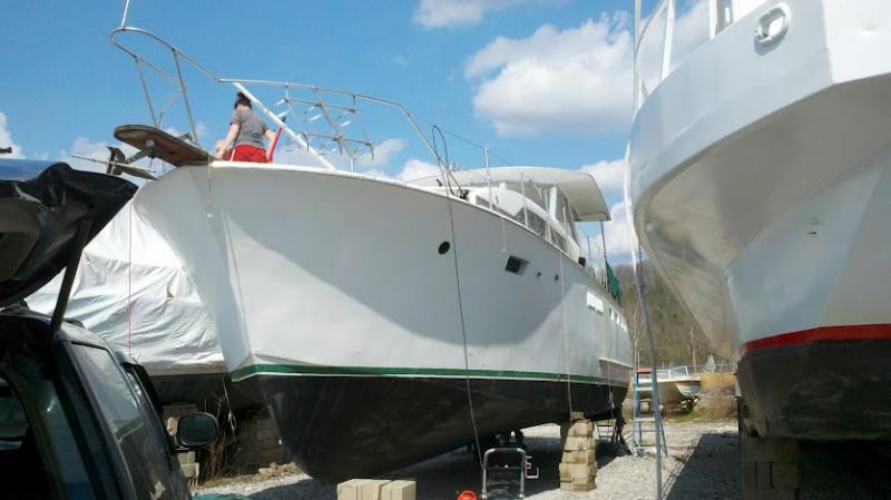

    and today

    okay need some help on a few things ...
    if anyone has a 46' could you please send me the details of the mast as mine is missing and I will need to make a new one ..also my rudders are stuck and I could use some ideas on breaking them loose i have been soaking them in p.b. blaster and sea foam deep creap , but they are staying right where they are at
    on a good note :] got both of the 8v71 motors up and going sound good for sitting in deep storage for 4 years .. also redid some wires and fired the gen set up . got all the toe rails off and looking at replacements for that .. whole bottom is getting new paint in the morning ...ohhh boy !!

    ohhh I hate cole tar but it works great ...
    good thing about having a brother 19 years younger he can climb like a monkey and craw under the boat like a champ
