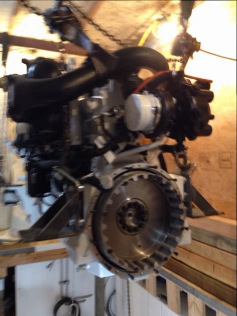

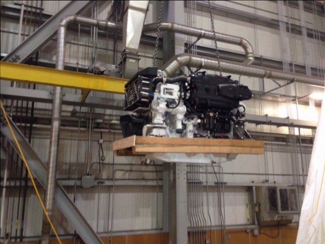

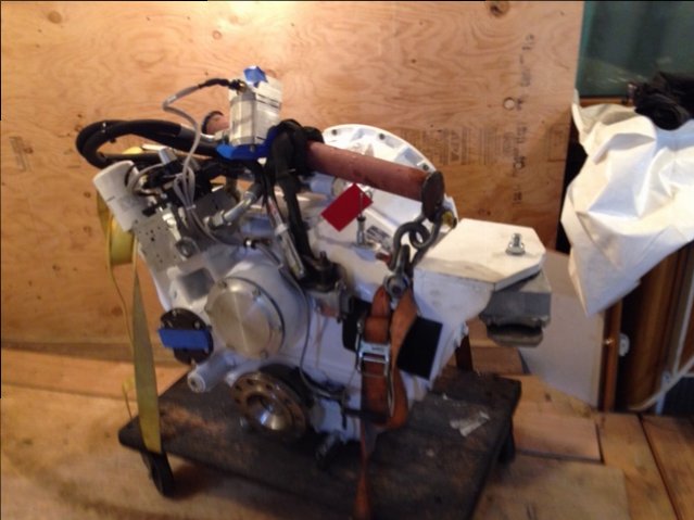

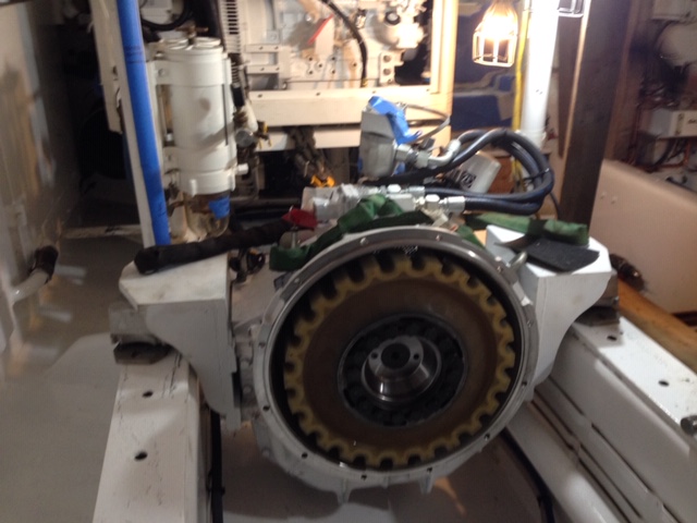

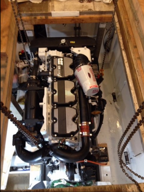

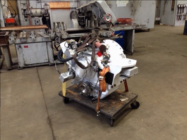

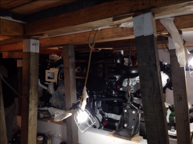

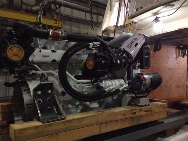

    STBD engine and gear is in the engine room. Gear was re-coupled to engine today. Photos in the engine room are not the greatest due to all the temporary shoring. Pictures are of gear, then engine, engine flying in on the ohvd crane, engine hanging in the rigging in the salon then in the engine room. The aft mount you see on the engine is only temporary. The finished mounts are on the front of engine and the gear. You can see these in the pictures.
    If you look closely in the picture of the gear (only) sitting on the stringers (3rd picture) you can see a white pipe running along the inboard stringer. This is our raw water feed pipe. The old DD's have the pump and raw water inlet in the rear of the engine and so that's where the inlet valves are on the hull. We didn't want the hassle of relocating the intakes and making holes and patches in the hull. So the sea valves remain aft of the engines and we bent 2.5" CuNi pipes to feed raw water up to the pumps and intakes on the left/fwd side of the CATs. These run under the engines so will be pretty much not be seen. They are made in two pieces just in case we ever need to get them out from under the engines.
    Everything seems to be fitting as expected. We now get to see that we have much more clearance around these I-6's vs the old V-12's. :):)

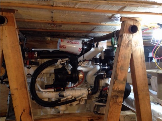

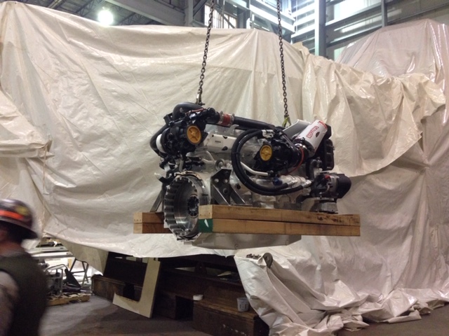

    IMG_0362.JPG IMG_0361.JPG IMG_0360.JPG The rest of the pictures for today:
